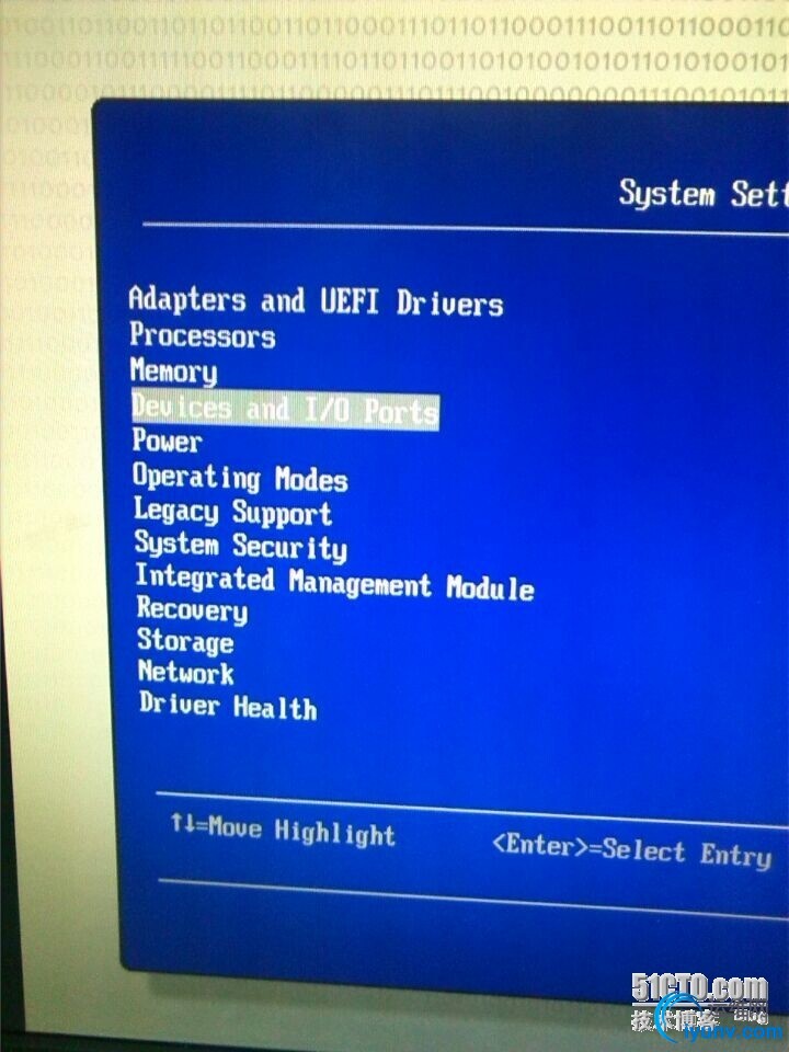

2 选择devices and I/O ports wKiom1RQyUnAtotaAAR743DyBl8035.jpg

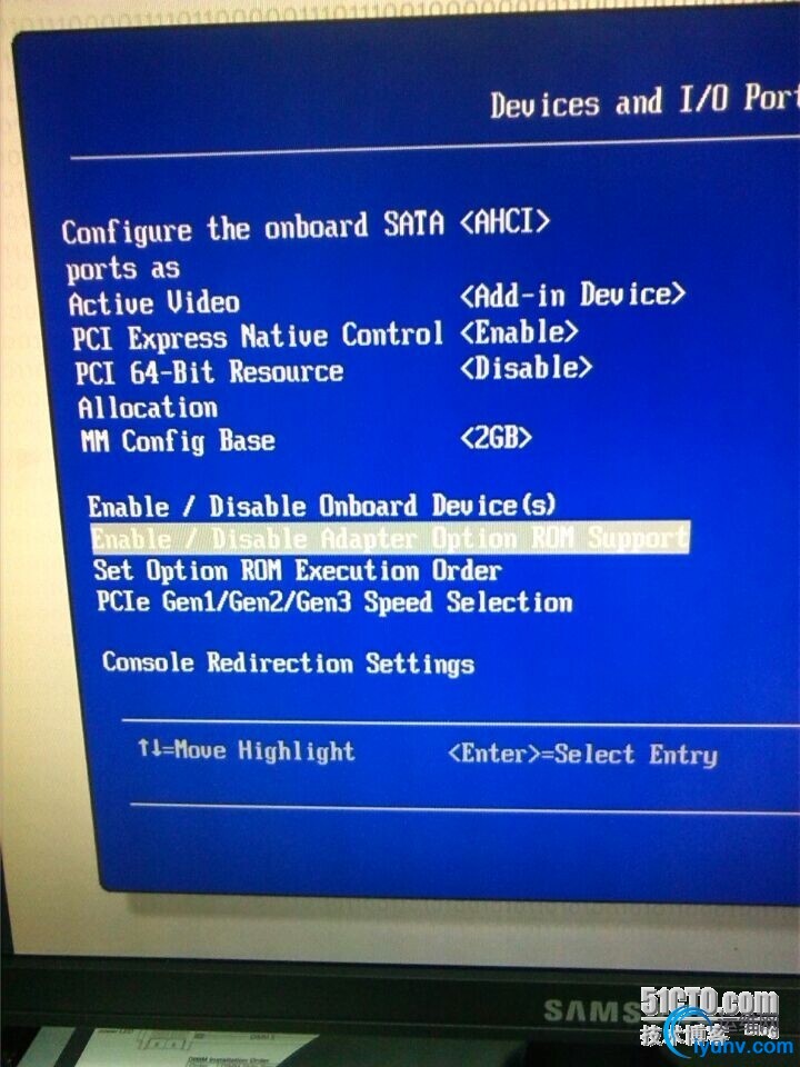

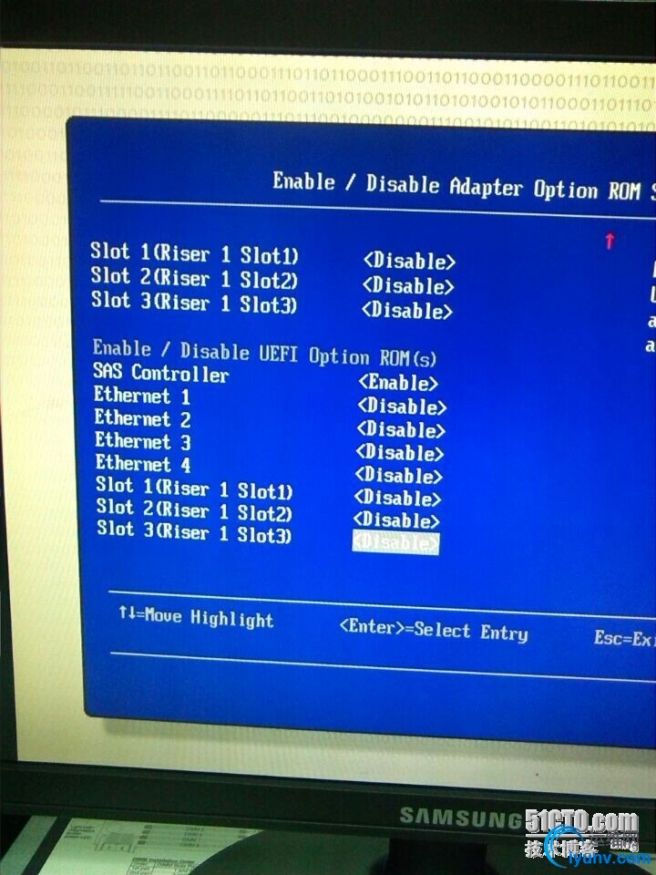

3 选择 enable /disable adapter option ROM support wKioL1RQyejy5tFXAAUUcw6-VsI284.jpg
