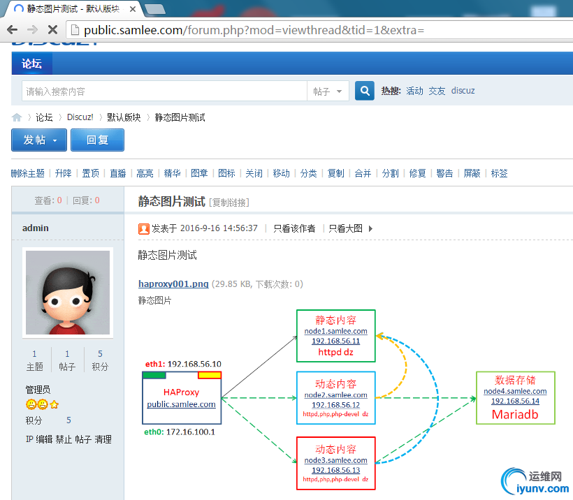

   下面通过案例架构详解HAproxy应用,架构图如下所示:

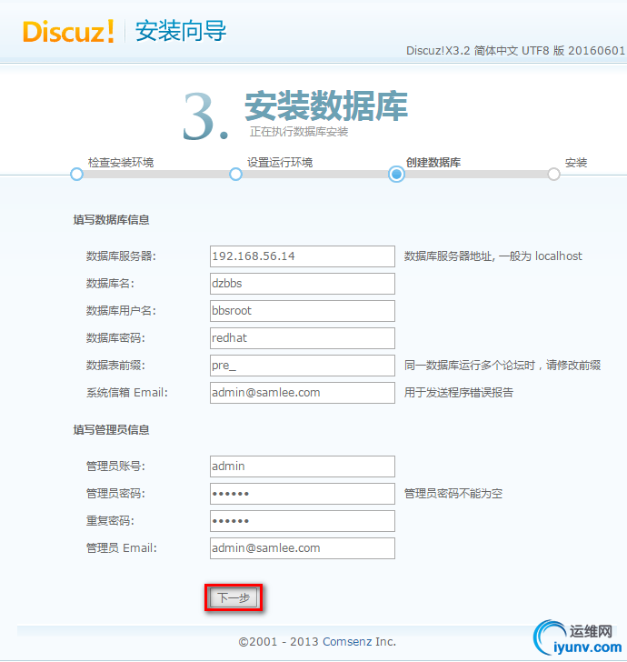

(6)部署discuz程序目录架构(node1下操作)
# wget  http://download.comsenz.com/DiscuzX/3.2/Discuz_X3.2_SC_UTF8.zip
# mkdir /usr/src/Discuz
# unzip -d /usr/src/Discuz /usr/src/Discuz_X3.2_SC_UTF8.zip
# cp -a /usr/src/Discuz/* /var/www/html/
# chmod -R 777 /var/www/html/upload/*
安装向导部署如下所示:

(1)使用地址http://public.samlee.com访问测试如下所示:
wKioL1fblfuyXTYaAAEPkTmASHI543.jpg (2)使用地址:http://public.samlee.com:5656/hadmin?stats访问测试--用户:haproxy 密码:redhat 如下所示:
(3)登录论坛上传图片测试:
在新窗口打开图片进行静态图片读取测试:
(4)测试cookie中记录samlee是否生效
(5)查询httpd日志状态如下所分析出,动静分离机制已实现:
# for i in node1 node2 node3;do ssh $i 'tail -1 /var/log/httpd/access_log';done
192.168.56.1 - - [16/Sep/2016:15:40:57 +0800] "GET /static/image/admincp/bg_login.gif HTTP/1.1" 200 475 "http://public.samlee.com/static/image/admincp/admincp.css" "Mozilla/5.0 (Windows NT 6.1; WOW64) AppleWebKit/537.36 (KHTML, like Gecko) Chrome/52.0.2743.116 Safari/537.36"
192.168.56.1 - - [16/Sep/2016:15:40:57 +0800] "GET /admin.php HTTP/1.1" 200 2686 "http://public.samlee.com/forum.php?mod=viewthread&tid=1&extra=page%3D1" "Mozilla/5.0 (Windows NT 6.1; WOW64) AppleWebKit/537.36 (KHTML, like Gecko) Chrome/52.0.2743.116 Safari/537.36"
192.168.56.1 - - [16/Sep/2016:15:40:59 +0800] "GET /misc.php?mod=patch&action=pluginnotice&inajax=1&ajaxtarget=plugin_notice HTTP/1.1" 200 65 "http://public.samlee.com/forum.php?mod=viewthread&tid=1&extra=page%3D1" "Mozilla/5.0 (Windows NT 6.1; WOW64) AppleWebKit/537.36 (KHTML, like Gecko) Chrome/52.0.2743.116 Safari/537.36"
