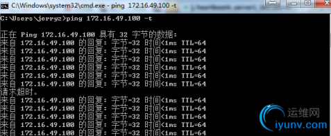

然后,将heartbeat01上的heartbeat服务关闭,再进行查看:
[iyunv@heartbeat01 ha.d]# /etc/init.d/heartbeat stop
Stopping High-Availability services: Done.
[iyunv@heartbeat01 ha.d]# ip addr |grep 172.16.49
    inet 172.16.49.133/24 brd 172.16.49.255 scope global eth1
[iyunv@heartbeat02 ha.d]# ip addr |grep 172.16.49
    inet 172.16.49.134/24 brd 172.16.49.255 scope global eth1
    inet 172.16.49.100/24 brd 172.16.49.255 scope global secondary eth1
可以看到,VIP已经从heartbeat01上转移到heartbeat02上了。
在VIP切换过程中,从另一台主机ping VIP地址,间断时间非常短暂。

Sep 22 05:44:26 heartbeat01.contoso.com heartbeat: [7284]: info: Comm_now_up(): updating status to active
Sep 22 05:44:26 heartbeat01.contoso.com heartbeat: [7284]: info: Local status now set to: 'active'
Sep 22 05:44:26 heartbeat01.contoso.com heartbeat: [7284]: info: Starting child client "/usr/lib64/heartbeat/ipfail" (498,499)
Sep 22 05:44:26 heartbeat01.contoso.com heartbeat: [7284]: debug: get_delnodelist: delnodelist=
Sep 22 05:44:26 heartbeat01.contoso.com heartbeat: [7312]: info: Starting "/usr/lib64/heartbeat/ipfail" as uid 498  gid 499 (pid 7312)
Sep 22 05:44:26 heartbeat01.contoso.com heartbeat: [7284]: info: Status update for node heartbeat02.contoso.com: status active
Sep 22 05:44:26 heartbeat01.contoso.com heartbeat: [7315]: debug: notify_world: setting SIGCHLD Handler to SIG_DFL
harc(default)[7315]:        2016/09/22_05:44:26 info: Running /etc/ha.d//rc.d/status status
Sep 22 05:44:26 heartbeat01.contoso.com ipfail: [7312]: debug: PID=7312
Sep 22 05:44:26 heartbeat01.contoso.com ipfail: [7312]: debug: Signing in with heartbeat
Sep 22 05:44:27 heartbeat01.contoso.com ipfail: [7312]: debug: [We are heartbeat01.contoso.com]
Sep 22 05:44:27 heartbeat01.contoso.com ipfail: [7312]: debug: auto_failback -> 1 (on)
Sep 22 05:44:27 heartbeat01.contoso.com ipfail: [7312]: debug: Setting message filter mode
Sep 22 05:44:28 heartbeat01.contoso.com ipfail: [7312]: debug: Starting node walk
Sep 22 05:44:29 heartbeat01.contoso.com ipfail: [7312]: debug: Cluster node: 172.16.49.1: status: ping
Sep 22 05:44:29 heartbeat01.contoso.com ipfail: [7312]: debug: Cluster node: heartbeat02.contoso.com: status: active
Sep 22 05:44:30 heartbeat01.contoso.com ipfail: [7312]: debug: [They are heartbeat02.contoso.com]
Sep 22 05:44:30 heartbeat01.contoso.com ipfail: [7312]: debug: Cluster node: heartbeat01.contoso.com: status: active
Sep 22 05:44:31 heartbeat01.contoso.com ipfail: [7312]: debug: Setting message signal
Sep 22 05:44:31 heartbeat01.contoso.com ipfail: [7312]: debug: Waiting for messages...
Sep 22 05:44:32 heartbeat01.contoso.com ipfail: [7312]: debug: Got join message from another ipfail client. (heartbeat02.contoso.com)
Sep 22 05:44:33 heartbeat01.contoso.com ipfail: [7312]: debug: Found ping node 172.16.49.1!
Sep 22 05:44:33 heartbeat01.contoso.com ipfail: [7312]: info: Asking other side for ping node count.
Sep 22 05:44:33 heartbeat01.contoso.com ipfail: [7312]: debug: Message [num_ping] sent.
Sep 22 05:44:36 heartbeat01.contoso.com ipfail: [7312]: info: No giveup timer to abort.
Sep 22 05:44:37 heartbeat01.contoso.com heartbeat: [7284]: info: remote resource transition completed.
Sep 22 05:44:37 heartbeat01.contoso.com heartbeat: [7284]: info: Initial resource acquisition complete (T_RESOURCES(us))
Sep 22 05:44:37 heartbeat01.contoso.com ipfail: [7312]: debug: Other side is now stable.
/usr/lib/ocf/resource.d//heartbeat/IPaddr(IPaddr_172.16.49.100)[7368]:        2016/09/22_05:44:37 INFO:  Resource is stopped
Sep 22 05:44:37 heartbeat01.contoso.com heartbeat: [7332]: info: Local Resource acquisition completed.
Sep 22 05:44:37 heartbeat01.contoso.com heartbeat: [7284]: debug: StartNextRemoteRscReq(): child count 1
Sep 22 05:44:37 heartbeat01.contoso.com heartbeat: [7451]: debug: notify_world: setting SIGCHLD Handler to SIG_DFL
harc(default)[7451]:        2016/09/22_05:44:37 info: Running /etc/ha.d//rc.d/ip-request-resp ip-request-resp
ip-request-resp(default)[7451]:        2016/09/22_05:44:37 received ip-request-resp IPaddr::172.16.49.100/24/eth1 OK yes
ResourceManager(default)[7474]:        2016/09/22_05:44:37 info: Acquiring resource group: heartbeat01.contoso.com IPaddr::172.16.49.100/24/eth1
/usr/lib/ocf/resource.d//heartbeat/IPaddr(IPaddr_172.16.49.100)[7502]:        2016/09/22_05:44:37 INFO:  Resource is stopped
ResourceManager(default)[7474]:        2016/09/22_05:44:37 info: Running /etc/ha.d/resource.d/IPaddr 172.16.49.100/24/eth1 start
IPaddr(IPaddr_172.16.49.100)[7627]:        2016/09/22_05:44:38 INFO: Adding inet address 172.16.49.100/24 with broadcast address 172.16.49.255 to device eth1
IPaddr(IPaddr_172.16.49.100)[7627]:        2016/09/22_05:44:38 INFO: Bringing device eth1 up
IPaddr(IPaddr_172.16.49.100)[7627]:        2016/09/22_05:44:38 INFO: /usr/libexec/heartbeat/send_arp -i 200 -r 5 -p /var/run/resource-agents/send_arp-172.16.49.100 eth1 172.16.49.100 auto not_used not_used
/usr/lib/ocf/resource.d//heartbeat/IPaddr(IPaddr_172.16.49.100)[7601]:        2016/09/22_05:44:38 INFO:  Success
INFO:  Success
Sep 22 05:44:40 heartbeat01.contoso.com heartbeat: [7284]: info: Heartbeat shutdown in progress. (7284)
Sep 22 05:44:40 heartbeat01.contoso.com heartbeat: [7716]: info: Giving up all HA resources.
ResourceManager(default)[7729]:        2016/09/22_05:44:40 info: Releasing resource group: heartbeat01.contoso.com IPaddr::172.16.49.100/24/eth1
ResourceManager(default)[7729]:        2016/09/22_05:44:40 info: Running /etc/ha.d/resource.d/IPaddr 172.16.49.100/24/eth1 stop
IPaddr(IPaddr_172.16.49.100)[7792]:        2016/09/22_05:44:40 INFO: IP status = ok, IP_CIP=
/usr/lib/ocf/resource.d//heartbeat/IPaddr(IPaddr_172.16.49.100)[7766]:        2016/09/22_05:44:40 INFO:  Success
INFO:  Success
Sep 22 05:44:40 heartbeat01.contoso.com heartbeat: [7716]: info: All HA resources relinquished.
Sep 22 05:44:41 heartbeat01.contoso.com heartbeat: [7284]: WARN: 1 lost packet(s) for [heartbeat02.contoso.com] [20:22]
Sep 22 05:44:41 heartbeat01.contoso.com ipfail: [7312]: debug: Other side is now stable.
Sep 22 05:44:41 heartbeat01.contoso.com heartbeat: [7284]: info: No pkts missing from heartbeat02.contoso.com!
Sep 22 05:44:41 heartbeat01.contoso.com heartbeat: [7284]: info: killing /usr/lib64/heartbeat/ipfail process group 7312 with signal 15
ARPING 172.16.49.100 from 172.16.49.100 eth1
Sent 5 probes (5 broadcast(s))
Received 0 response(s)
Sep 22 05:44:43 heartbeat01.contoso.com heartbeat: [7284]: info: killing HBFIFO process 7288 with signal 15
Sep 22 05:44:43 heartbeat01.contoso.com heartbeat: [7284]: info: killing HBWRITE process 7289 with signal 15
Sep 22 05:44:43 heartbeat01.contoso.com heartbeat: [7284]: info: killing HBREAD process 7290 with signal 15
Sep 22 05:44:43 heartbeat01.contoso.com heartbeat: [7284]: info: killing HBWRITE process 7291 with signal 15
Sep 22 05:44:43 heartbeat01.contoso.com heartbeat: [7284]: info: killing HBREAD process 7292 with signal 15
Sep 22 05:44:43 heartbeat01.contoso.com heartbeat: [7284]: info: Core process 7292 exited. 5 remaining
Sep 22 05:44:43 heartbeat01.contoso.com heartbeat: [7284]: info: Core process 7289 exited. 4 remaining
Sep 22 05:44:43 heartbeat01.contoso.com heartbeat: [7284]: info: Core process 7290 exited. 3 remaining
Sep 22 05:44:43 heartbeat01.contoso.com heartbeat: [7284]: info: Core process 7291 exited. 2 remaining
Sep 22 05:44:43 heartbeat01.contoso.com heartbeat: [7284]: info: Core process 7288 exited. 1 remaining
Sep 22 05:44:43 heartbeat01.contoso.com heartbeat: [7284]: info: heartbeat01.contoso.com Heartbeat shutdown complete.
