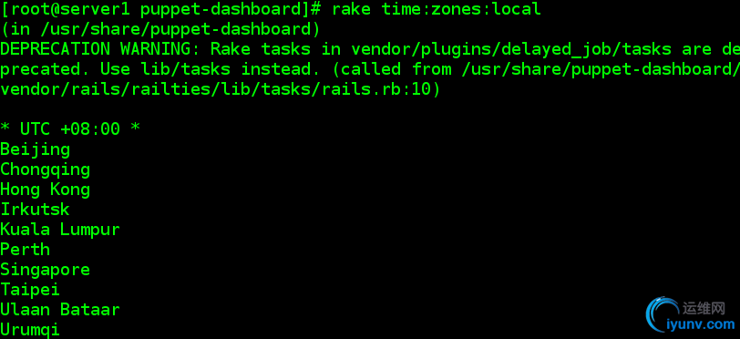

4)修改puppet-dashboard 默认时区
#//查看puppet-dashboard 默认支持的时区
#rake gems:refresh_specs
#rake time:zones:local
# vim /usr/share/puppet-dashboard/config/settings.yml
      //puppet-dashboard 默认时区不正确,需要修改
    time_zone: 'Beijing'

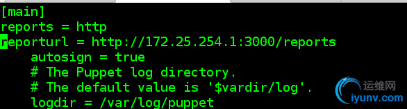

7)修改服务器的配置文件
# vim /etc/puppet/puppet.conf
[main]//添加以下两项
reports = http
reporturl = http://172.25.254.1:3000/reports
#/etc/init.d/puppetmaster restart

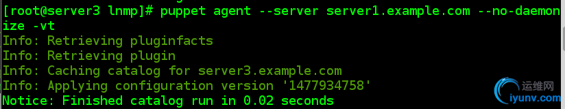

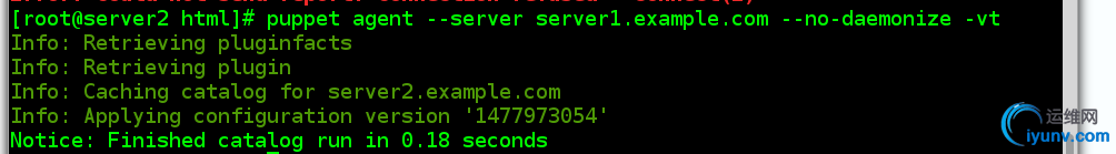

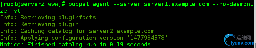

8)设置 client 端
      server2与server3同时设置如下
#vim /etc/puppet/puppet.conf
[agent]//添加以下行
report = true
# puppet agent --server server1.example.com --no-daemonize -vt//同步数据

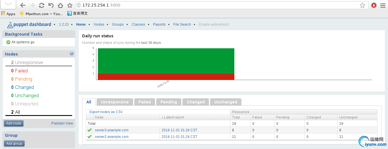

9) 浏览器访问 172.25.254.1:3000

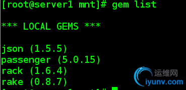

1)[iyunv@server1 mnt]# gem list
*** LOCAL GEMS ***
json (1.5.5)
rack (1.6.4)

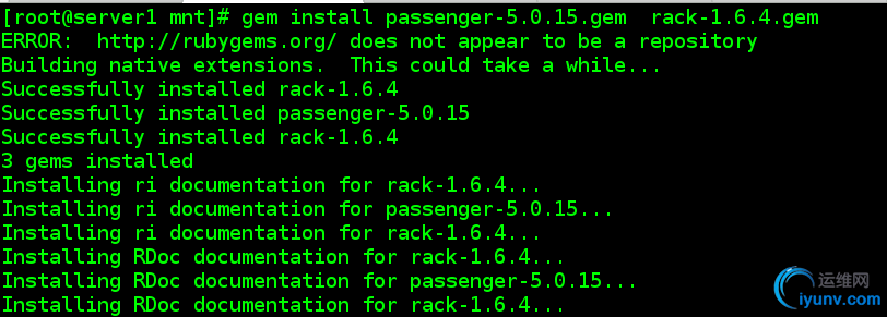

2)不够就下载
# gem install passenger-5.0.15.gem rack-1.6.4.gem

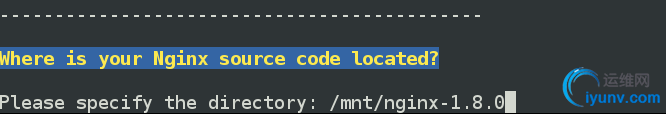

3) # yum install -y gcc gcc-c++ curl-devel zlib-devel openssl-devel ruby-devel

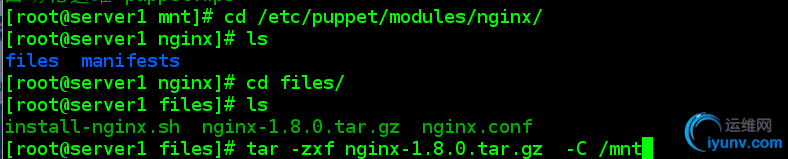

# tar zxf nginx-1.8.0.tar.gz -C /mnt

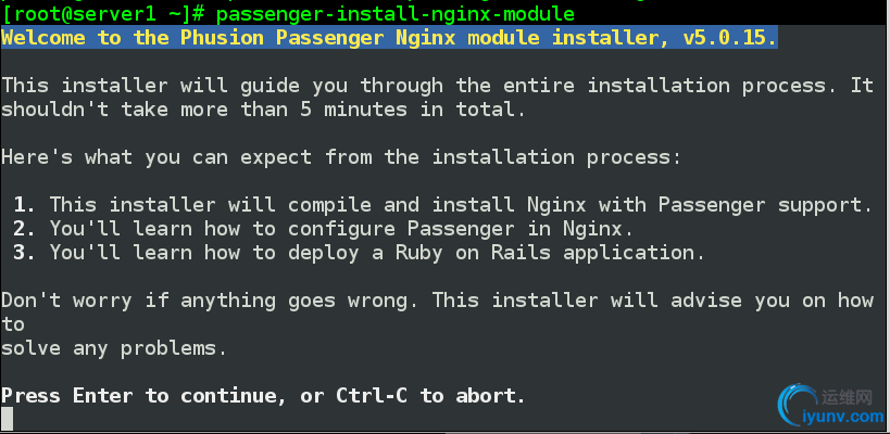

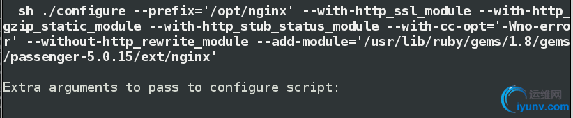

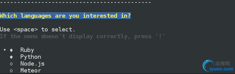

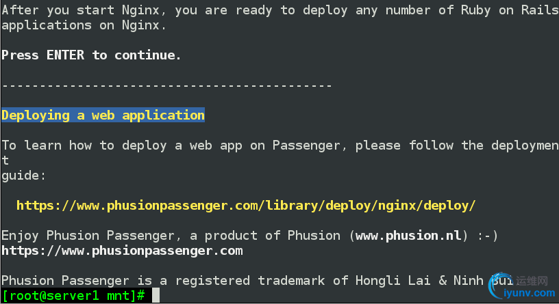

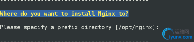

4) #passenger-install-nginx-module
  //脚本会自动安装 nginx 支持,按提示操作,其它按Enter就好,编译过程比较慢
5) nginx 默认安装在/opt/nginx 目录:

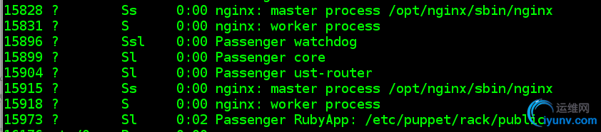

# /opt/nginx/sbin/nginx   ###开启nginx,可以看到客户端可以获取到信息
#ps -ax   ###查看进程启动情况
