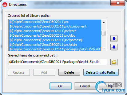

To fix this simply just find the corresponding file mentioned in the errormessage from the subdirectory "src" in the placewhere the checkout was done and add the full path in the Path libray Delphi(Menu Tools -> Options -> Environment Options -> DelphiOptions -> Library).
To avoid this andseveral other reports of this type, add each of the subdirectories for thesource code of the Library Path ZeosLib, as shown in the picture below.
Note that thedefinition of the paths I use "$ (DelphiComponents) \".
In my work there is anenvironment variable called DelphiComponents that is intendedto refer to the directory where all the components / third-party packages arelocated.
This facilitates themigration and use of different versions of components without requiringreconfiguration of the path in the projects or in the Delphi IDE.
If you have not or willnot add this environment variable, just replace "$(DelphiComponents) \" path by which the ZeosDBO is located (whichthis article is D: \ Delphi \ Components \ ZeosDBO2011).
NOTE: If after addingthe directories in the Delphi Library Path continues to display the errormessage, just close it and reopen it. Do not forget to reopen it withadministrator permissions!

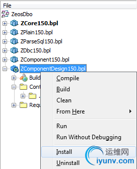

4. Install the package of components by selecting the "Install" (fromthe context menu) package "ZComponentDesign150.bpl";
If you try to installthe package "ZComponentDesign150.bpl" is displayedan error message like the image below, it means that Delphi did not find thefile. GLP specific.

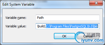

The most practical and quick to fix this problem is to enter the directorywhere this. BPL is located in the PATH system.
Note that when builder packages ZeosLib will be created a directory located inthe subdirectory called build. "\ Packages \ delphi15."
So, just add this path (D: \ Delphi \ Components \ ZeosDBO2011 \ packages \delphi15 \ build) in the directory listing of the environment variable "PATH".
NOTE: Any changes in the environment variables will require close and reopenthe Delphi for the changes to take effect.

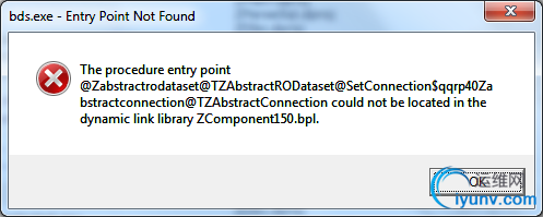

If you try to install the package "ZComponentDesign150.bpl" isdisplayed an error message same as or similar to the image below, was probablyan oversight in the specification of the path ZeosDBO.
Classify as careless because this error was caused when he was trying toinstall ZeosDBO who was in a path different from that referenced in the SystemPath and Library Path (in the Delphi IDE).
So, be sure to indicate exactly all the path to the directory where the ZeosDBis located.

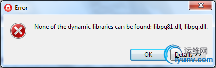

After changing the component and set the Connected property to True forthe first time, a notification error like the image below was presented.
This is a classicproblem that is solved or by copying the necessary files to the project folderor by adding the directory where those files are located in the PATH system.
All DLLs are located inthe subdirectory "bin" of the PostgreSQLinstallation directory (probably C: \ Program Files \ PostgreSQL \ 9.0\ bin).
As shown in the picture above, the chosen solution was to add the PostgreSQLinstallation directory to the PATH system that is not necessary to have torecopy the DLLs for new projects that use the ZeosDBO.
After this was only necessary to close and reopen the Delphi and the connectionwas as expected.

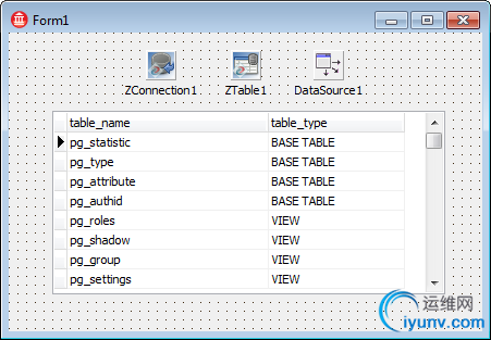

After a successful connection, I performed some tests with the basic componentsto display the records of the tables.
In the picture below you can notice the DBGrid component displaying informationin the table "INFORMATION_SCHEMA.TABLES."
Despite a few basic tests done in design mode, the components apparently areworking well. I did not notice any kind of failure.
