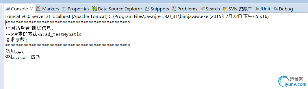

  编写测试代码(部分):
@Resource
AdminDao adminDao;
public String testMybatis() {
AdminEntity adminEntity = new AdminEntity();
adminEntity.setName("ccw");
adminEntity.setPassword("ccw");
adminDao.addAdminEntity(adminEntity);
System.out.println("添加成功");
AdminEntity adminEntity2 = adminDao.getAdminEntityByName("ccw");
System.out.println("查找:"+adminEntity2.getName()+"  成功");
return SUCCESS;
  最后部署运行:
  恭喜你,集成成功了!!
