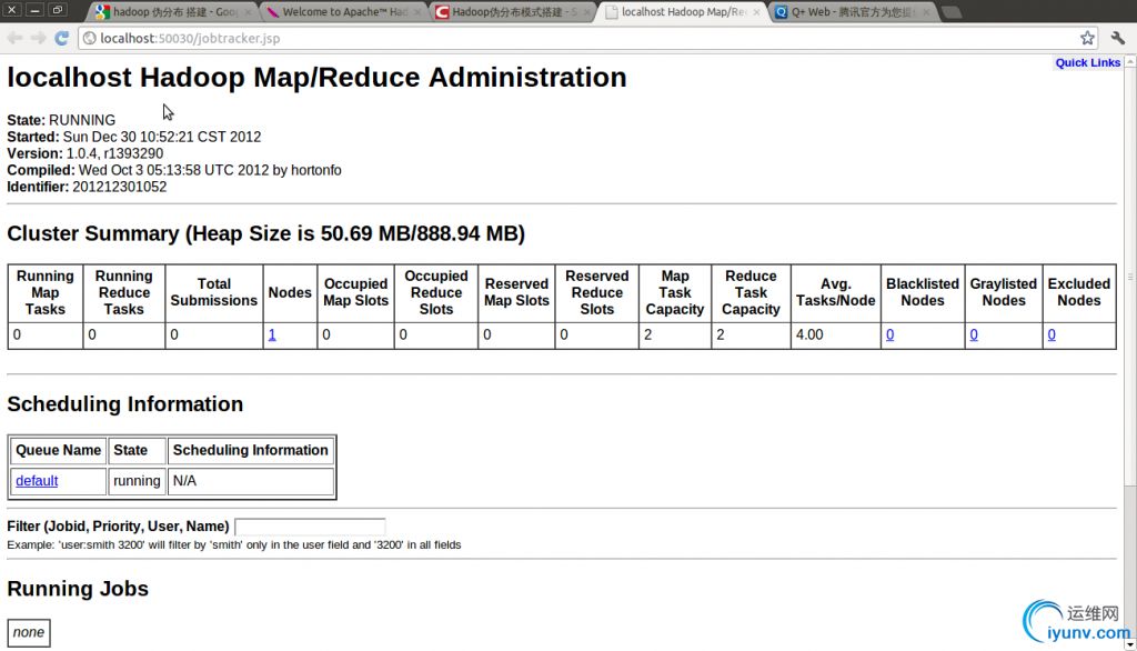

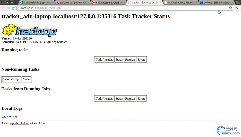

8. 检查运行状态
Hadoop管理界面:http://localhost:50030
Hadoop Task Tracker 状态:http://localhost:50060
