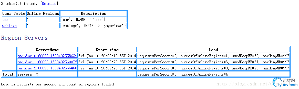

    当然, 使用HBase Shell命令来创建几个表也是可以的(slf4J的配置有点冗余,主要是HBase的pom.xml配置的修改,后续会fix掉的)。
[app@hadoop-master ~]$ hbase shell
14/01/10 20:19:33 INFO Configuration.deprecation: hadoop.native.lib is deprecated. Instead, use io.native.lib.available
HBase Shell; enter 'help<RETURN>' for list of supported commands.
Type "exit<RETURN>" to leave the HBase Shell
Version 0.94.14, rUnknown, Wed Jan  8 04:02:25 EST 2014
hbase(main):001:0> list
TABLE
SLF4J: Class path contains multiple SLF4J bindings.
SLF4J: Found binding in [jar:file:/opt/hbase/lib/slf4j-log4j12-1.6.1.jar!/org/slf4j/impl/StaticLoggerBinder.class]
SLF4J: Found binding in [jar:file:/opt/hadoop/share/hadoop/common/lib/slf4j-log4j12-1.7.5.jar!/org/slf4j/impl/StaticLoggerBinder.class]
SLF4J: See http://www.slf4j.org/codes.html#multiple_bindings for an explanation.
car
weblogs
2 row(s) in 3.1790 seconds
