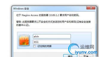

http://10.89.1.2/nagios
如果登录后提示错误:
It appears as though you do not have permission to view information for any of the hosts you requested...
If you believe this is an error, check the HTTP server authentication requirements for accessing this CGI
and check the authorization options in your CGI configuration file.
编辑 cgi.cfg
[iyunv@nagios objects]# cd ../
[iyunv@nagios etc]# vi cgi.cfg
# PHYSICAL HTML PATH
# This is the path where the HTML files for Nagios reside.  This
# value is used to locate the logo images needed by the statusmap
# and statuswrl CGIs.
physical_html_path=/usr/local/nagios/share
:g/nagiosadmin/s//alvin/g           #替换nagiosadmin 为 alvin,该用户是我安装的时候添加的
保存并退出
[iyunv@nagios objects]# /etc/init.d/nagios reload
