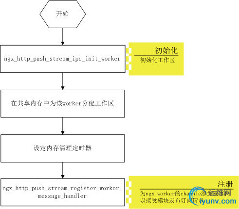

2.  ngx worker初始化(ngx_http_push_stream_init_worker)
