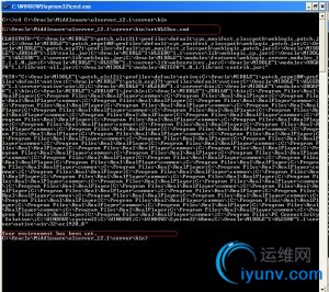

  i) Setting up your environment.
  Add WebLogic Server classes to the CLASSPATH environment variable andWL_HOME\server\bin to the PATH environment variable. OR
  You can use a C:\Oracle\Middleware\wlserver_12.1\server\bin\setWLSEnv.cmd script to set both variables.

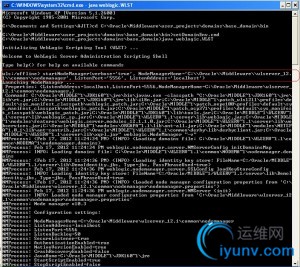

  ii) Start WLST Session using command : java weblogic.WLST

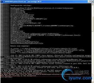

  iii) Start Node Managerusing command :
  startNodeManager(verbose=’true’, NodeManagerHome=’C:\\Oracle\\Middleware\\wlserver_12.1\\common\\nodemanager’, ListenPort=’5556′, ListenAddress=’localhost’)

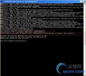

  iv) Connect WLST to a Node Manager by entering the nmConnect command.
  nmConnect(‘weblogic’, ‘weblogic123′, ‘localhost’, ’5556′, ‘base_domain’ , ‘C:\\Oracle\\Middleware\\user_projects\\domains\\base_domain’ , ‘ssl’)
  note: Node Manager security relies on a one-way SSL connection between the client and server.If you are establishing a command line connection to the Java Node Manager using the WebLogic Server Scripting Tool (WLST) nmConnect command, youprovide the Node Manager user name and password(here weblogic and weblogic123 respectively). Node Manager verifies the username and password against the domain’s nm_password.properties file.Node Manager credentials are located on the Security>General>AdvancedOptions of Console page.Administration Console users do not need to explicitly provide credentials to connect to Node Manager—the Node Manager user name and password are available in the domain configuration and are provided automatically.

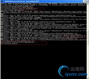

  v) Use the nmStart command to start a server.
nmStart(‘AdminServer’)
  Monitor the status of the Administration Server by entering the nmServerStatus command.
nmServerStatus(‘AdminServer’)

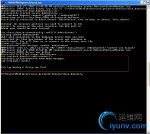

  viii) Stop the server by entering the nmKill command.
nmKill(‘Server-0‘)
  ix) Stop theAdminServer by entering the nmKill command.
nmKill(‘AdminServer‘)
  x) Disconnect the node manager :nmDisconnect()and Exit the WLST:exit()
