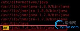

Starting LSB: Jenkins Continuous Integration Server...
Starting Jenkins bash: /usr/bin/java: No such file or directory
Feb 27 09:03:12 test-bcliunx-3 jenkins: [FAILED]
没有找到 java 命令
查看java 命令
/opt/jdk1.7.0_51/bin/java
解决方法修改 jenkins 启动脚本
vim /etc/rc.d/init.d/jenkins
添加下面的文件
