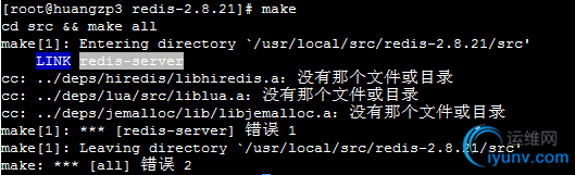

1. 下载安装扩展源及源码包
yum install -y epel-release jemalloc-devel
wget https://codeload.github.com/antirez/redis/tar.gz/2.8.21
tar -zxvf 2.8.21
make;make PREFIX=/usr/local/redis install
mkdir -p /usr/local/redis/etc
    解决办法:
    cd deps/
    make hiredis lua jemalloc

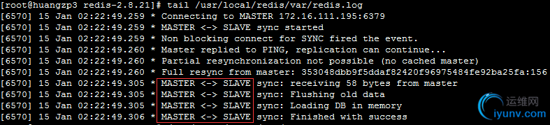

    3)重启看日志显示已经同步(关闭防火墙)

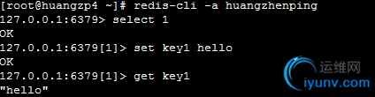

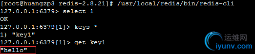

2. 测试redis主从
    master上:
    slave上:

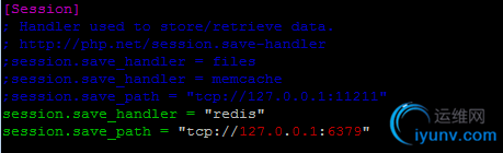

2. 编辑php的配置文件vim /usr/local/php/etc/php.ini,加载扩展模块
3. Redis实现session共享三种方式
    A)/usr/local/php/etc/php.ini文件中添加
       session.save_handler = "redis"
       session.save_path = "tcp://127.0.0.1:6379"

    1) 采用A方式,编辑php的配置文件vim /usr/local/php/etc/php.ini

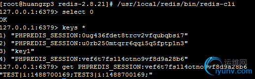

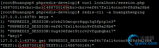

  3) curl工具测试
    redis主:
    redis从:
