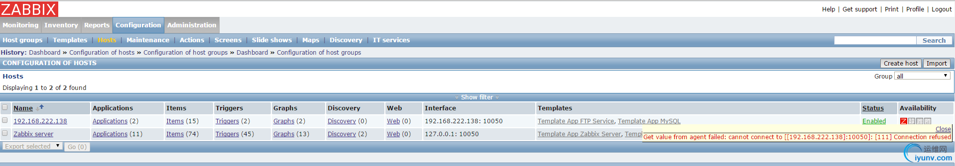

  2、
 Get value from agent failed: cannot connect to [[192.168.222.138]:10050]: [111] Connection refused
        解决方法:在被监控机器上打开zabbix_agent
