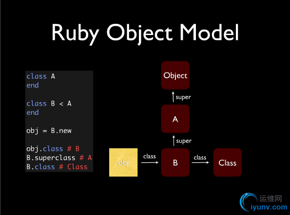

inheritance
python 中支持多继承,ruby 不支持多继承但是支持mixin
python 多继承的查找链规则: This is depth-first, left-to-right
ruby 中的查找链规则:self->mixin->super
class Base():
pass
class Car():
pass
class BMW(Base,Car):
pass
ruby中的继承:
in the diagram below, "normal" classes are green, and meta-classes are blue. The dashed lines represent "instance off" (the "klass" pointer), and the solid lines represent "inherits" (the "super" method):

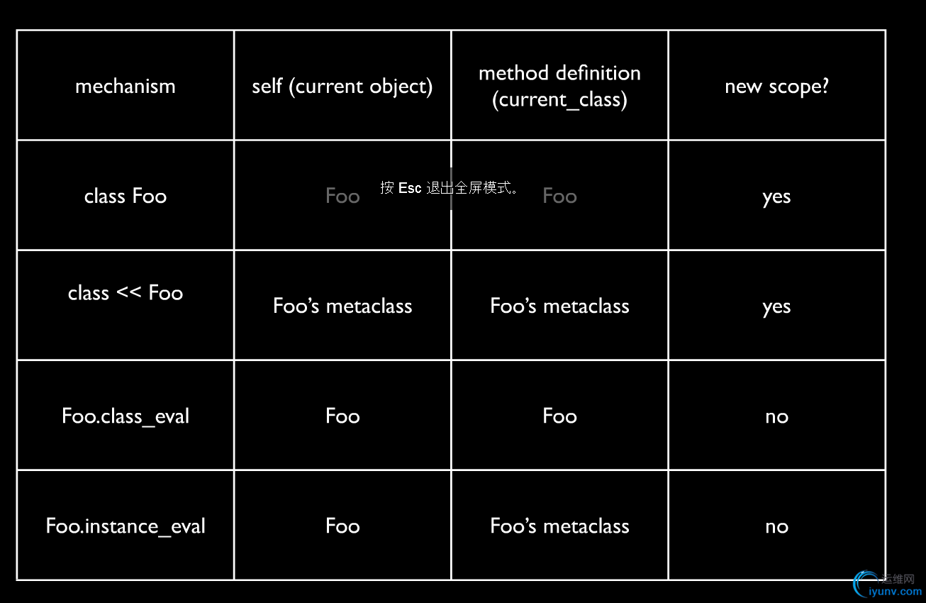

令人困惑地instance_eval and class_eval
Use ClassName.instance_eval to define class methods.
Use ClassName.class_eval to define instance methods.
That’s right. Not a typo. Here are some examples, shamelessly stolen from his post:
# Defining a class method with instance_eval
Fixnum.instance_eval { def ten; 10; end }
Fixnum.ten #=> 10
# Defining an instance method with class_eval
Fixnum.class_eval { def number; self; end }
7.number #=> 7

ruby metaprogramming
yes = "yes"
ok = "ok"
String.class_eval do
define_method(yes) do
print ok
end
end
puts "123".yes #=> ok
#create singleton methods
#String.class_eval do
# class << self
#         define_method(yes) do
#           print ok
#         end
# end
#end
#puts String.yes
#C:/Users/liuzheng/Desktop/a.rb:46:in `singletonclass': undefined local variable
#or method `yes' for #<Class:String> (NameError)
#        from C:/Users/liuzheng/Desktop/a.rb:45:in `block in <main>'
#        from C:/Users/liuzheng/Desktop/a.rb:44:in `class_eval'
#        from C:/Users/liuzheng/Desktop/a.rb:44:in `<main>'
#because class << self has new scope
yes = "yes"
ok = "ok"
metaclass = (class <<String; self;end)
metaclass.class_eval do
puts ok
end
end
puts String.yes => "ok"
