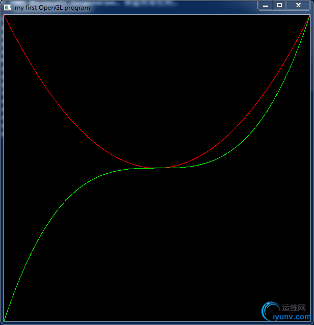

#!/usr/bin/perl -w
use strict;
use warnings;
use OpenGL qw/ :all /;
use OpenGL::Config;
glutInit();
glutInitDisplayMode(GLUT_RGB|GLUT_SINGLE);
glutInitWindowPosition(100,100);
glutInitWindowSize(600,600);
glutCreateWindow("my first OpenGL program");
glutDisplayFunc(\&mydis);
glutMainLoop();
return 0;
sub mydis()
my $x=-1;
my $y;
my $z=-1;
glClearColor(0,0,0,255);
glClear(GL_COLOR_BUFFER_BIT);
glPointSize(1);
glBegin(GL_POINTS);
for (0..10000)
$x+=0.001;
$z+=0.001;
$y=$x**2;
glColor3f(255,0,0);
glVertex2f($x,$y);
$y=$z**3;
glColor3f(0,255,0);
glVertex2f($x,$y);
glEnd();
glFlush();
  绘制x平方和x立方
