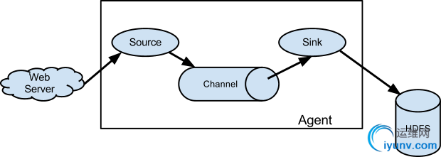

Flume基本架构图:
一个Agent中有Source、Channel和Sink。Sink可以连接HDFS,JMS或者其他的Agent Source
Flume术语解释

  • Agent
  Flume agent is a (JVM) process that hosts the components(Source、Channel、Sink) through which events flow from an external source to the next destination (hop).
  • Source
  Flume Agent的Source用于接收外部数据源发送过来的数据(例如上例中的Web Server),注意的是,外部数据源发送的数据必须满足Agent Source定义的数据源的格式。比如对于Avro Source,那么这个Source仅接收Avro格式的数据,外部数据源可以通过Avro Client的方式给Agent的Source发送数据;Avro Source也可以接收其它Agent的Avro Sink发送的Avro Event数据。(A Flume source consumes events delivered to it by an external source like a web server. The external source sends events to Flume in a format that is recognized by the target Flume source. For example, an Avro Flume source can be used to receive Avro events from Avro clients or other Flume agents in the flow that send events from an Avro sink)
  • Channel
  Agent Channel是Agent Source接收到数据的一个缓冲,数据在被消费前(写入到Sink)对读取到的数据进行缓冲。When a Flume source receives an event, it stores it into one or more channels. The channel is a passive store that keeps the event until it’s consumed by a Flume sink. The file channel is one example – it is backed by the local filesystem
  • Sink
  The sink removes the event from the channel and puts it into an external repository like HDFS (via Flume HDFS sink) or forwards it to the Flume source of the next Flume agent (next hop) in the flow.
  • Source和Sink的异步特性
  The source and sink within the given agent run asynchronously with the events staged in the channel.

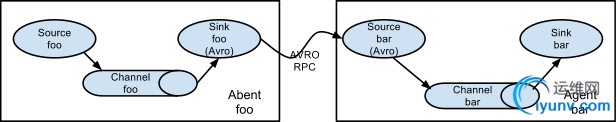

  Agent可以组合,构成流式处理系统,Agent foo的输出作为Agent bar的输入,Pipe处理。同时一个Agent可以有多个Channel和Sink,因而同一条日志,可以同时流向不同的地方,比如HDFS,JMS或者另外的Agent。

  多个Agent可以输出到一个Agent,这样就构成了聚合Consolidateion的效果,
 两个Agent组合产生多级处理
