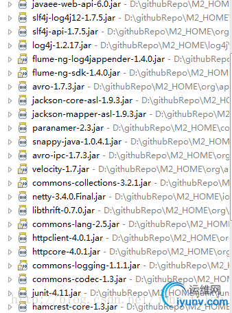

  这里采用flume-ng-log4appender作为客户端,演示这个数据传递的实例。准备如下jar包。
[table][/table]   DSC0000.jpg

# File Appender rootLog
log4j.rootLogger=DEBUG,stdout,rootLog
#console configure for DEV environment
log4j.appender.stdout=org.apache.log4j.ConsoleAppender
log4j.appender.stdout.layout=org.apache.log4j.PatternLayout
log4j.appender.stdout.layout.ConversionPattern=%d{yyyy-MM-ddHH:mm:ss,SSS}%-5p(%c:%L)- %m%n
log4j.appender.rootLog=org.apache.log4j.RollingFileAppender
log4j.appender.rootLog.File=rootLog.log
log4j.appender.rootLog.MaxFileSize=5000KB
log4j.appender.rootLog.MaxBackupIndex=20
log4j.appender.rootLog.layout=org.apache.log4j.PatternLayout
log4j.appender.rootLog.layout.ConversionPattern=%d{yyyy-MM-ddHH:mm:ss,SSS}%-5p(%c:%L)- %m%n
# File Appender boentel
#log4j.logger.com.boentel=DEBUG,boentel
#log4j.additivity.com.boentel=true
#log4j.appender.boentel=org.apache.log4j.RollingFileAppender
#log4j.appender.boentel.File= boentel.log
#log4j.appender.boentel.MaxFileSize=2000KB
#log4j.appender.boentel.MaxBackupIndex=20
#log4j.appender.boentel.layout=org.apache.log4j.PatternLayout
#log4j.appender.boentel.layout.ConversionPattern=%d{yyyy-MM-ddHH:mm:ss,SSS} %-5p (%c:%L) - %m%n
#log4j.logger.com.loadbalance= DEBUG,loadbalance
#log4j.additivity.com.loadbalance= true
#log4j.appender.loadbalance =org.apache.flume.clients.log4jappender.LoadBalancingLog4jAppender
#log4j.appender.loadbalance.Hosts = machine-0:51515 machine-1:51515 hadoop-master:51515
#log4j.appender.loadbalance.UnsafeMode = true
#log4j.appender.out2.MaxBackoff = 60000
#FQDN RANDOM ,defaultis ROUND_ROBIN
#log4j.appender.loadbalance.Selector = ROUND_ROBIN
#log4j.appender.loadbalance.layout=org.apache.log4j.PatternLayout
#log4j.appender.loadbalance.layout.ConversionPattern=%d{yyyy-MM-ddHH:mm:ss,SSS} %-5p (%c:%L) - %m%n
log4j.logger.com.loadbalance=DEBUG,flume
log4j.additivity.com.loadbalance=true
#single node machine
log4j.appender.flume= org.apache.flume.clients.log4jappender.Log4jAppender
log4j.appender.flume.Hostname= hadoop-master
log4j.appender.flume.Port= 51515
log4j.appender.flume.UnsafeMode= true
log4j.appender.flume.layout= org.apache.log4j.PatternLayout
log4j.appender.flume.layout.ConversionPattern= %d{yyyy-MM-dd HH:mm:ss,SSS}%-5p(%c:%L)- %m%n
  启动app,一段时间后,观察数据是否有丢失。我使用几个case测试不过,没有发现任务问题。
