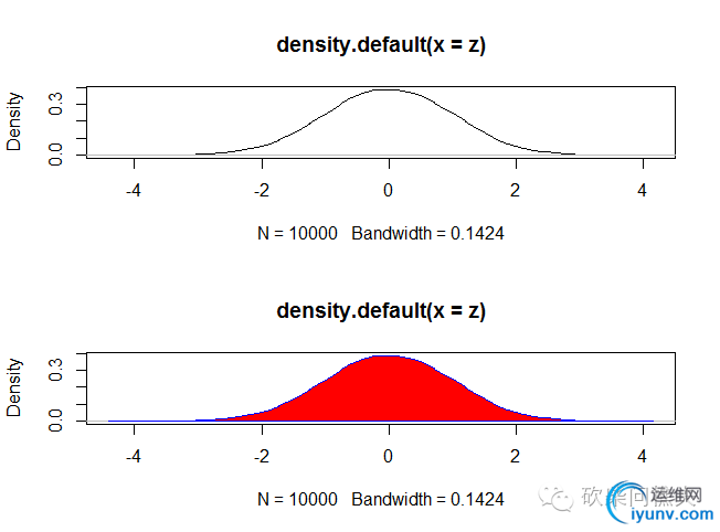

  绘制密度图
  mean=k*p
  var=k*p*(1-p)
  z=(x-mean)/sqrt(var)
  hist(z)

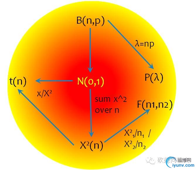

  几种分布关系图示:
  i2mean=function(x,n=10){
  k=length(x)
  nobs=k/n
  xm=matrix(x,nobs,n)
  y=rowMeans(xm)
  return (y)
  par(mfrow=c(5,1),mar = c(3,4,1,1))
  #Binomia
  p=.05
  n=100
  k=10000
  x=i2mean(rbinom(k, n,p))
  d=density(x)
  plot(d,main="Binomial")
  #Poisson
  lambda=10
  x=i2mean(rpois(k, lambda))
  d=density(x)
  plot(d,main="Poisson")
  #Chi-Square
  x=i2mean(rchisq(k,5))
  d=density(x)
  plot(d,main="Chi-square")
  #F
  x=i2mean(rf(k,10, 10000))
  d=density(x)
  plot(d,main="F dist")
  #t
  x=i2mean(rt(k,5))
  d=density(x)
  plot(d,main="t dist")
