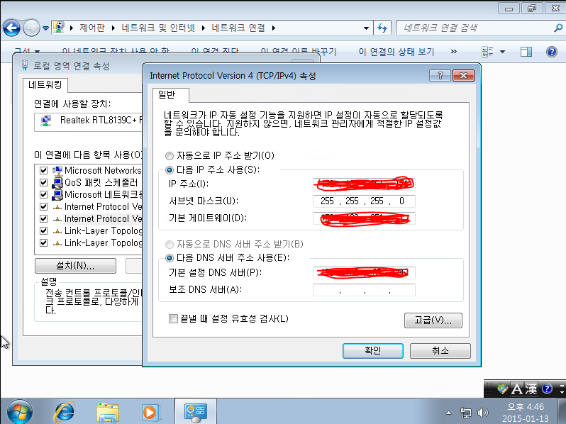

Setup public ip to virtual machine

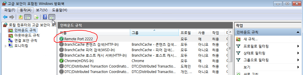

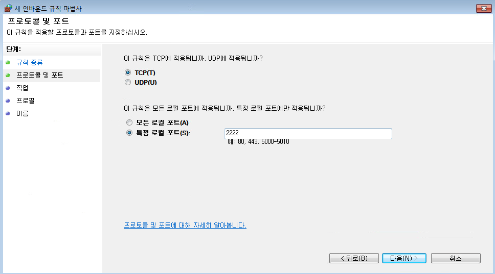

Setup remote access with port 2222(course there is no DVI output on GridK1,K2)
My Computer(Right Click) -> Option -> Remote Setup -> Access All
Control Panel -> Windows Firewall -> Advanced Setting -> Inbound Rule -> New Rule -> Port -> TCP and Special Port(?): 2222 -> Named "Remote Poart 2222"

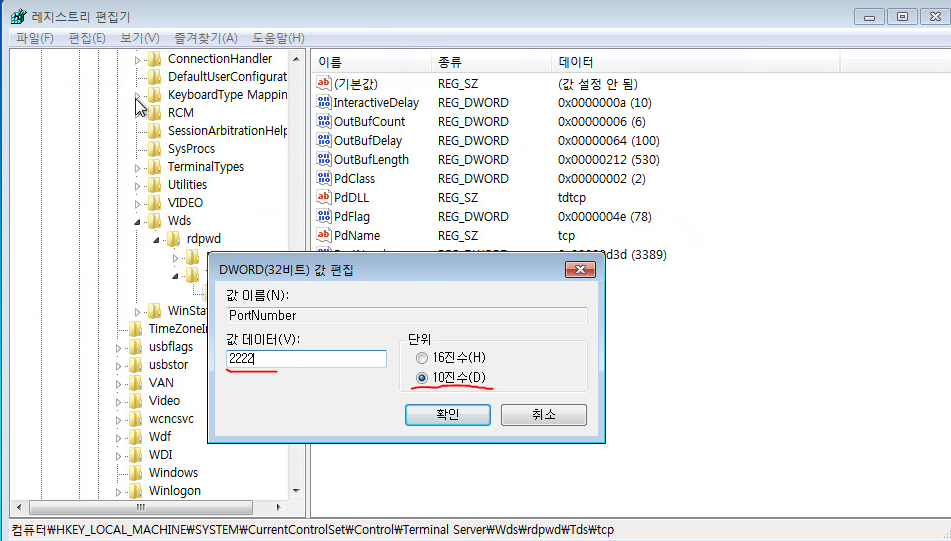

run->regedit
  • HKEY_LOCAL_MACHINE -> SYSTEM -> CurrentControlSet -> Control -> Terminal server -> Wds -> rdpwd -> Tds -> tcp ->PortNumber
  • HKEY_LOCAL_MACHINE -> SYSTEM -> CurrentControlSet -> Control -> Terminal server -> WinStations -> RDP-Tcp -> PortNumber
  Edit 10 value as 2222
we can use xxx.xxx.xxx.x:2222 to remote access.

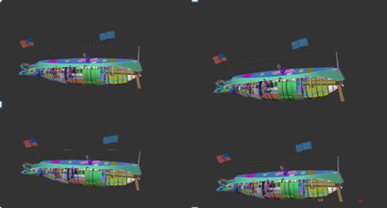

  • Specviewperf 11 Click Here to Download

  • Run Specviewperf 11
