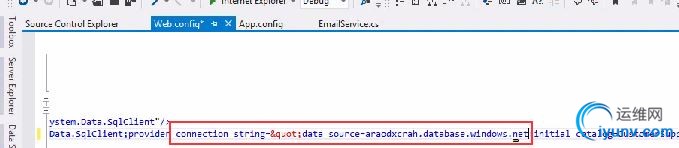

  change the setting to point to Azure db

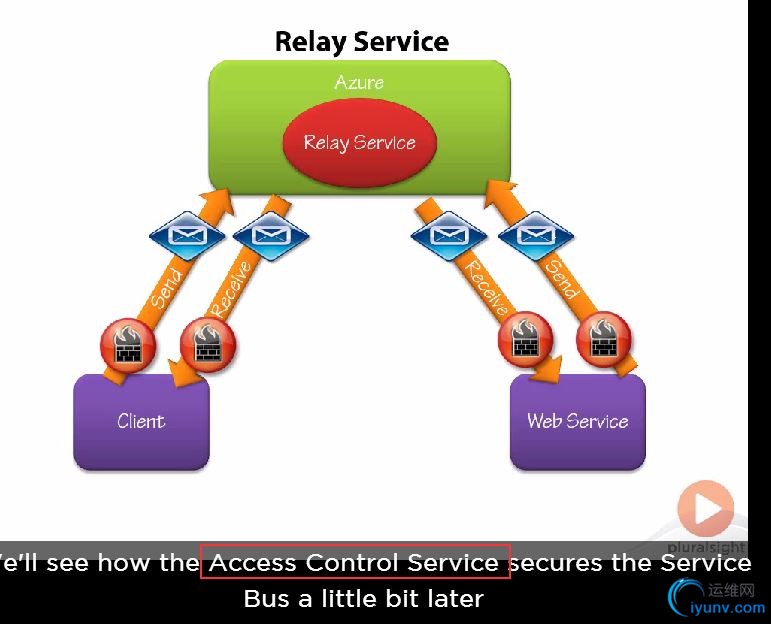

ServiceBus.
  Client app to communicate with backend app if they are in same net work which should be easy.
  If they are in different env and communicating behind fire wall that will be cubersome.
  ServiceBus Relay service can play a role of trusted party to help both side to communicate particularly useful in hybrid architecture.

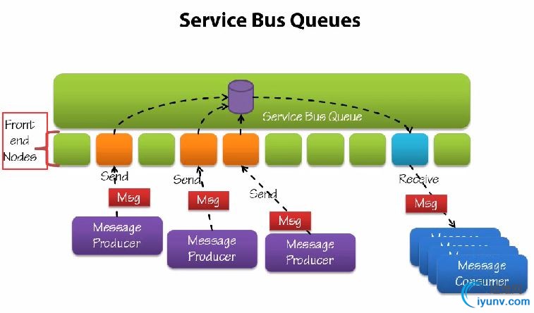

  MSMQ - > ServieBus Queue
  SB queue is storage location for messages, msmq to servicebus queue is comparatively simple requires mimimum re-coding.
  Relay service
  The typical use scenario is point to point communiction, client to server service call or server to server service call

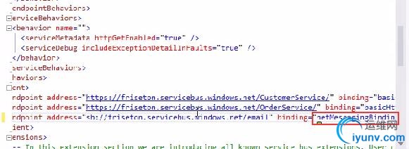

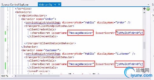

Change application to use ServiceBus.
  Having the service resides at on-prem to be called by client anywhere out of on-prem is a big challeges to be resloved with relay service
  Client used to point to local msmq now to service bus queue with binding change to NetMessagingBinding
  Client used to listen on local msmq now to service bus queue

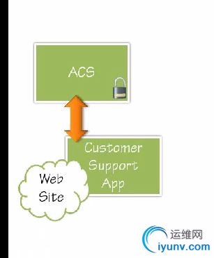

  Web applicaiton & Authentication migration

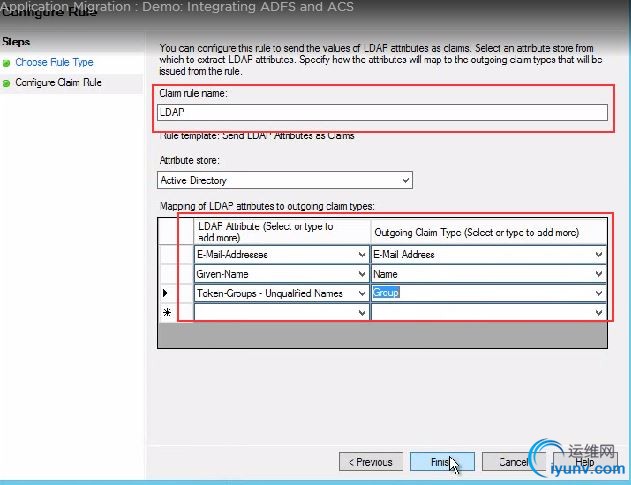

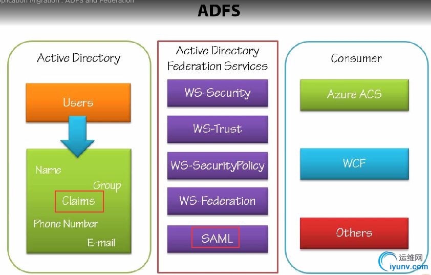

Our scenario - Moving the local website and authention to the azure using web role and authentication access control
  Active Dirctory Federation Service will query Active Directory base on different standard, SAML claim returns comprehensive ifno for NAME, GROUP and EMAIL

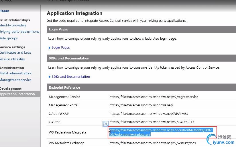

  ACS host at Azure offers endpoint for ADFS at local AD server to point to get meta data
DSC00020.jpg DSC00021.jpg   Paste the ACS metadata URL to Relying Party at local AD
