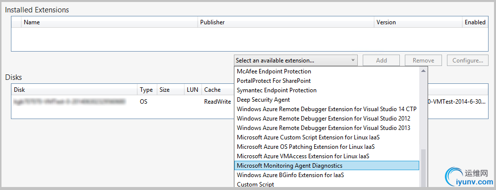

  第一个链接中图文并茂的说明了如何启用虚拟机监控的扩展以及监控性能技术器的数据:
  微软的Blog资源果然牛逼,说的非常详细。
  启动VS连接Azure,竟然找不到图中Azure的管理UI,细想一下也对,不是所有的VS使用者都需要操作Azure,这个Azure的管理UI应该是VS的一个Plugin。
  咨询了搞大数据的朱哥,发给我一个在线安装程序:选择安装Microsoft Azure SDK for .net(VS 2015)-2.8.1

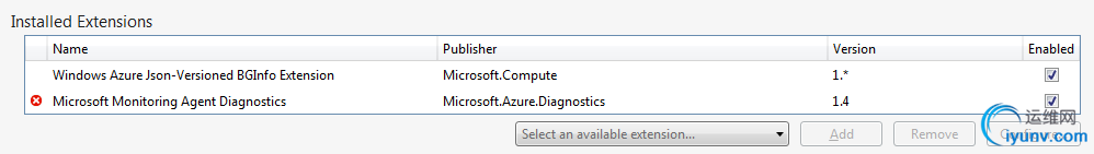

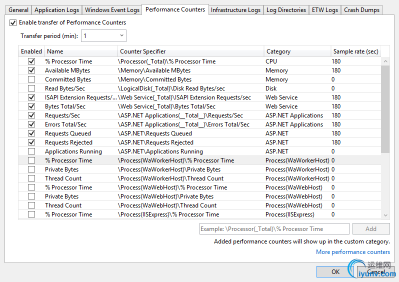

  安装完成后,Azure的管理菜单出来了,然后选择要监控的虚拟机,添加Microsoft Monitoring Agent Diagnostics,Configure,监控自定义性能计数器,然后保存:
  重新刷新后,扩展启用报错了:
  错误信息:Microsoft.Azure.Diagnostics.IaaSDiagnostics, version 1.4.2.1) with exception Command C:\Packages\Plugins\Microsoft.Azure.Diagnostics.IaaSDiagnostics\1.4.2.1\DiagnosticsPluginLauncher.exe of Microsoft.Azure.Diagnostics.IaaSDiagnostics has exited with code -3
  在虚拟机中的C:\Packages\Plugins\Microsoft.Azure.Diagnostics.IaaSDiagnostics\1.4.2.1\Logs中,找下了更多的错误信息:

  {"WadCfg":{"DiagnosticMonitorConfiguration":{"PerformanceCounters":{"PerformanceCounterConfiguration":[{"annotation":[],"counterSpecifier":"\\Memory\\Available MBytes","sampleRate":"PT3M"},{"annotation":[],"counterSpecifier":"\\Web Service(_Total)\\ISAPI Extension Requests/sec","sampleRate":"PT3M"},{"annotation":[],"counterSpecifier":"\\Web Service(_Total)\\Bytes Total/Sec","sampleRate":"PT3M"},{"annotation":[],"counterSpecifier":"\\ASP.NET Applications(__Total__)\\Requests/Sec","sampleRate":"PT3M"},{"annotation":[],"counterSpecifier":"\\ASP.NET Applications(__Total__)\\Errors Total/Sec","sampleRate":"PT3M"},{"annotation":[],"counterSpecifier":"\\ASP.NET\\Requests Queued","sampleRate":"PT3M"},{"annotation":[],"counterSpecifier":"\\ASP.NET\\Requests Rejected","sampleRate":"PT3M"},{"annotation":[],"counterSpecifier":"\\Processor(_Total)\\% Processor Time","sampleRate":"PT3M"}],"scheduledTransferPeriod":"PT1M"},"overallQuotaInMB":4096}}

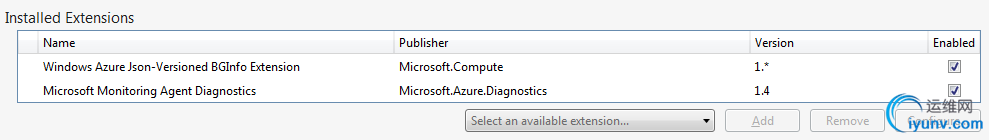

  因此,将本机2.8版本全部卸载,安装2.7版本:
  https://www.microsoft.com/en-us/download/details.aspx?id=48178
  基于2.7这个版本的Azure管理工具启用虚拟机监控扩展,OK。
