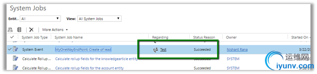

  Now we go and create a lead record, which triggers our plugin and creates a system job for it.
  The system job fails as we do not have any active listener at the end point.

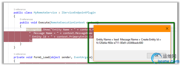

  Basically, we need to implement IServiceEndPointPlugin Interface, create a Service Host, define a new transportclientendpointbehaviour with shared access signature token provider, use WS2007HttpRelayBinding in our service end point.
  Now run the listener application, and create a lead record in CRM.
  We can see the break point hit in our listener application' Execute method. Execute method is invoked whenever a message is posted to the service bus by Microsoft Dynamics 365.
  System Job also shows the status as succeeded as we had our listener registered to the endpoint and running.
