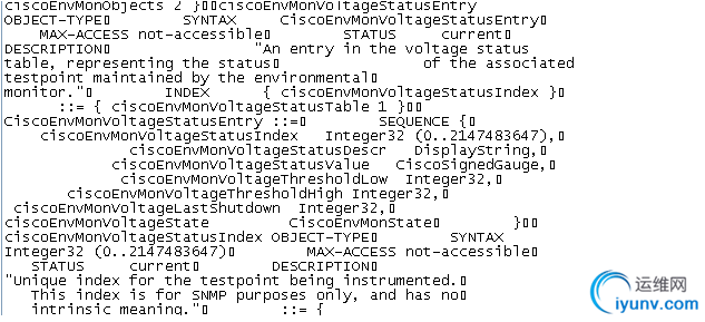

Private OID:
Many manufactures can supply custom MIB files for their hardware ,such as temperature , fan speed.
The MIB file is hard to read, they are only meant to be imported, or "compiled " by a Management Station.
Below is an example of Cisco MIB file for environment monitoring.
Cisco MIB information:

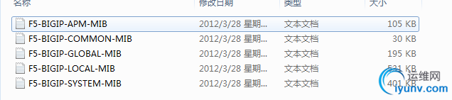

Load MIB file:
The files below is F5 MIB file.
We can use MIB Browser to load these file ,and you can see the F5 private OID in the picture.
