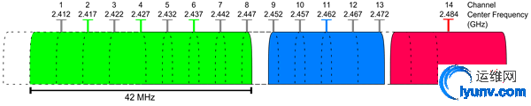

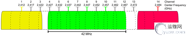

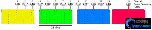

  Illustrations of 2.4GHz Channels
  These illustrations show ALL Wifi channels but channel 14 is only available in Japan for B spec, so you can pretty much forget about your dreams to fit two 40MHz channels in the 2.4GHz Spectrum. As you can see, there is barely enough room to fit three non-overlapping 20MHz channels, or one 40MHz channel + one 20MHz channel. The tops of the blocks reflect the actual 20 or 40 MHz required by the channel whereas the bottoms account for the extra 1MHz on each end that the channel is allowed to attenuate, hence the 22MHz and 42MHz maximum widths. It may be possible to use channel 1 Upper and 13 Lower to produce two 40MHz channels but the signals may bleed into each other with that 1MHz they're each allowed to before attenuating.

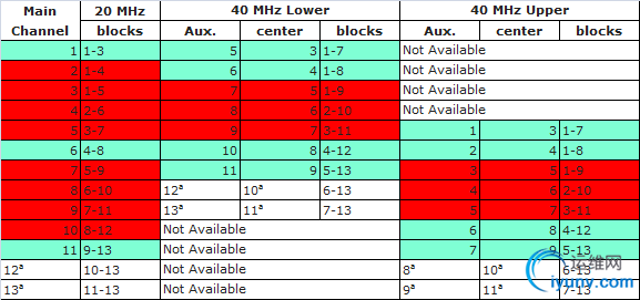

  Table of 2.4GHz Channels
  Green are good choices that have minimal overlap, Red are bad choices that overlap too much, and White are uncommonly used channels that should only be used in substitute of channel 11.
  a = Setting generally not supported by devices in the U.S.
