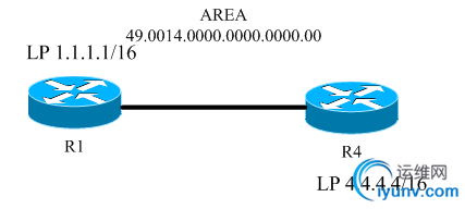

LAB1.使用IS-IS协议构建集成的IP网络:
Step1.规划IS-IS区域,规划每个路由器的NET(network entity title)/网络实体标识。
NET:-------|-----------|------- (16进制)
    Area-ID, System-ID, NSEL
   1-13byte,  6byte,     1byte(路由器固定是00)
router isis
net 49.0014.0000.0000.0002.00
    area id |system id    |NSEL
Step2.配置IP地址:
Step3.在接口中激活IS-IS的运行,为IP 网络进行路由(让IS-IS为这个接口所在的网段进行路由)
int s0
ip router isis
Step4.察看IS-IS的邻居建立:
show clns
R4#show clns
Global CLNS Information:
  2 Interfaces Enabled for CLNS
  NET: 49.0014.0000.0000.0004.00
  Configuration Timer: 60, Default Holding Timer: 300, Packet Lifetime 64
  ERPDU's requested on locally generated packets
  Running IS-IS in IP-only mode (CLNS forwarding not allowed)
show clns protocol
show clns neighbors
show clns interface
show clns route
show clns database
show clns topology
show ip route

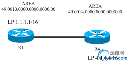

Step5.控制接口的IS-IS的Level类型(默认是L1L2)
int s0
isis circuit-type level-2/Level-1
