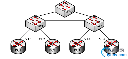

   LAB2:跨交换机的同一VLAN通讯:
    STEP1:构建Trunk:
    Trunk有两种→有自动协商:
    802.1Q的Trunk:(c-i)#switchport trunk encapsulation dot1q →switchport mode trunk ;
    ISL的Trunk:(c-i)#switchport trunk encapsulation isl →switchport mode trunk ;
    两个交换机要配置相同的Trunk;
    STEP2:察看Trunk链路的连接状态:
    #sh int tru 。
