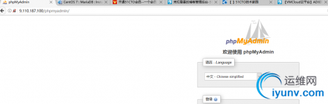

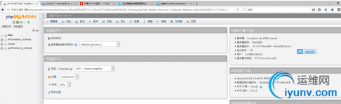

4 安装设置phpMyAdmin
[iyunv@mysql ~]# yum --enablerepo=epel -y install phpMyAdmin php-mysql php-mcrypt
[iyunv@mysql ~]# vi /etc/httpd/conf.d/phpMyAdmin.conf
<IfModule mod_authz_core.c>
     15      # Apache 2.4
     16      <RequireAny>
     17        Require ip 127.0.0.1 9.110.187.100/24
     18        Require ip ::1
     19      </RequireAny>
     20    </IfModule>
     21    <IfModule !mod_authz_core.c>
     22      # Apache 2.2
     23      Order Deny,Allow
     24      Deny from All
     25      Allow from 127.0.0.1
     26      Allow from ::1
     27    </IfModule>
     28 </Directory>
     29
     30 <Directory /usr/share/phpMyAdmin/setup/>
     31    <IfModule mod_authz_core.c>
     32      # Apache 2.4
     33      <RequireAny>
     34        Require ip 127.0.0.1 9.110.187.100/24
     35        Require ip ::1
     36      </RequireAny>
     37    </IfModule>
[iyunv@mysql ~]# systemctl restart httpd
