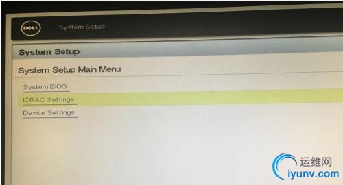

首先,我们需要在BIOS中启用iDRAC功能1、启动Dell服务器,按F2 System Setup,打开BIOS界面,选择iDRAC Settings 8fc4e4c57415344115869e40b5eeaa36.jpg-wh_500x0-wm_3-wmp_4-s_1483574640.jpg

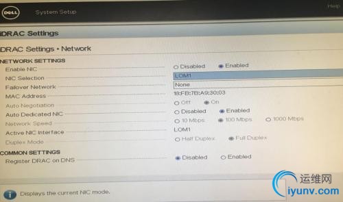

2、在IDRAC Settings界面中选择Network 1da06a56113139de1af0bab72453aa4f.jpg-wh_500x0-wm_3-wmp_4-s_2412705498.jpg
3、在Network界面中 Enable NIC,并且选择NIC接口,我这边为LOM1 5bffa5d1e01e2d1e01aaa7bb4dc8e5f0.jpg-wh_500x0-wm_3-wmp_4-s_1470841922.jpg
