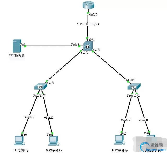

                      拓扑图如下:

设备配置如下:
SW:
SW#sh run
Building configuration...
Current configuration : 1538 bytes
version 12.2
no service timestamps log datetime msec
no service timestamps debug datetime msec
no service password-encryption
hostname Switch
ip routing
spanning-tree mode pvst
interface FastEthernet0/1
switchport trunk encapsulation dot1q
switchport mode trunk
interface FastEthernet0/2
interface FastEthernet0/3
interface FastEthernet0/4
interface FastEthernet0/5
interface FastEthernet0/6
interface FastEthernet0/7
interface FastEthernet0/8
interface FastEthernet0/9
interface FastEthernet0/10
interface FastEthernet0/11
interface FastEthernet0/12
interface FastEthernet0/13
interface FastEthernet0/14
interface FastEthernet0/15
interface FastEthernet0/16
interface FastEthernet0/17
interface FastEthernet0/18
interface FastEthernet0/19
interface FastEthernet0/20
interface FastEthernet0/21
interface FastEthernet0/22
interface FastEthernet0/23
interface FastEthernet0/24
interface GigabitEthernet0/1
interface GigabitEthernet0/2
interface Vlan1
ip address 192.168.0.254 255.255.255.0
interface Vlan10
ip address 192.168.10.254 255.255.255.0
ip helper-address 192.168.0.20
interface Vlan20
ip address 192.168.20.254 255.255.255.0
ip classless
line con 0
line aux 0
line vty 0 4
login
end
SW#

注意:
DHCP DISCOVER 是以广播方式进行的,其情形只能在同一网段之内进行,因为路由器是不会将二层广播包转发出去的。需配置DHCP中继代理(ip helper-address)
