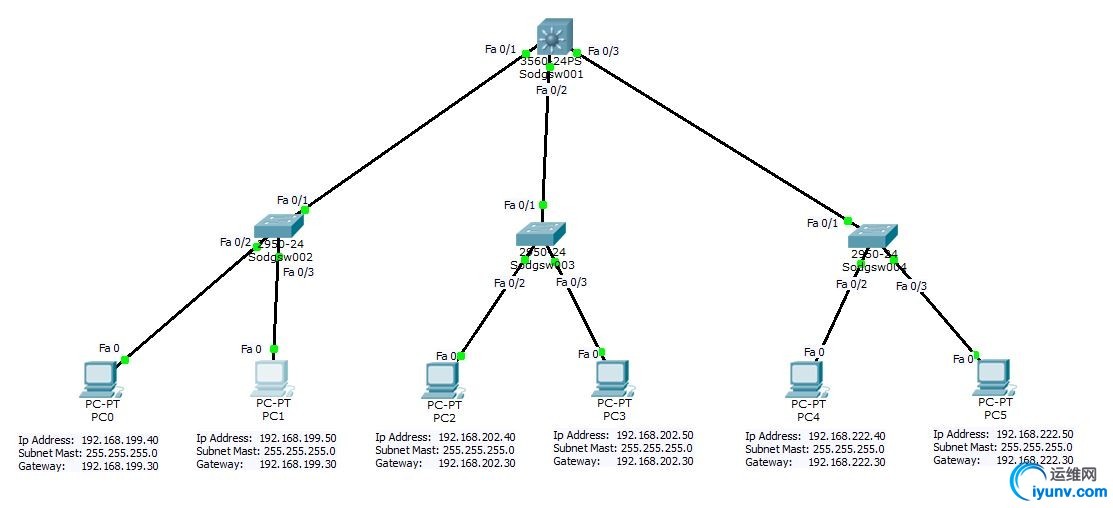

Task
Vlan2 Vlan3 Vlan4 communication for each other. The network map as below.
Environment:Cisco Packet Tracer
Condition1.Multilayer Switch(Cisco 3560-24ps) 1
2.Cisco 2950-24 switch 3
3.Desktop 6
4.Network Cable
Solution
1. Network Cable Connection
Sodgsw001  Fa 0/1-------Fa 0/1 Sodgsw002
Sodgsw001  Fa 0/2-------Fa 0/1 Sodgsw003
Sodgsw001  Fa 0/3-------Fa 0/1 Sodgsw004
Sodgsw002  Fa 0/2-------Fa 0 PC0
Sodgsw002  Fa 0/3-------Fa 0 PC1
Sodgsw003  Fa 0/2-------Fa 0 PC2
Sodgsw003  Fa 0/3-------Fa 0 PC3
Sodgsw004  Fa 0/2-------Fa 0 PC4
Sodgsw004  Fa 0/3-------Fa 0 PC5

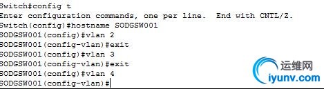

3.Config SODGSW001.
Change switch name to SODGSW001
Create Vlan2 Vlan3 Vlan4
Set Vlan Ip
Set switchport mode to trunk
Run Switch Routing function
4.Config SODGSW002.
Change the hostname to sodgsw002 fetch.php?media=cisco_router:communicatebetweenvlan7.jpg
add vlan2 vlan3 vlan4 run in the switch
Config switchport, arrange vlan 2 to all connection workstation
5.Config SODGSW003.

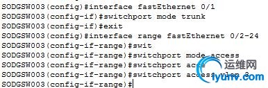

Change the hostname to sodgsw003
Config switchport,arrange vlan3 to all connection workstation

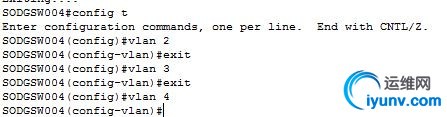

6.Config SODGSW004.
Change the hostname to sodgsw004
Config switchport,arrange vlan4 to all connection workstation

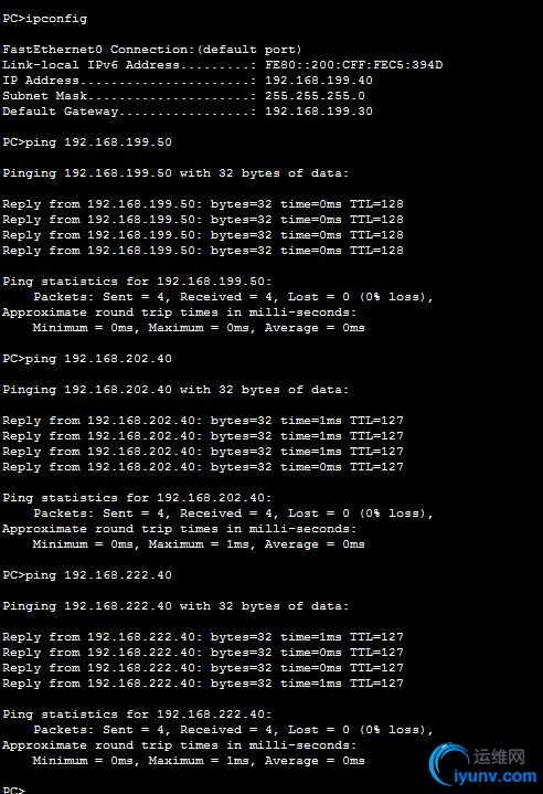

Make test
Test 1: from Vlan2 to ping vlan2 vlan3 Vlan4
Go to PC0 make ping.   Result: Pass

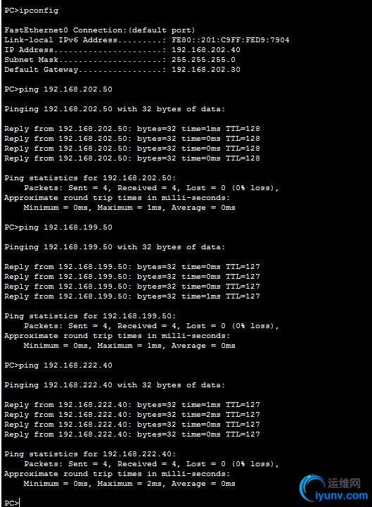

Test 2: from Vlan3 to ping vlan2 vlan3 Vlan4
Go to PC2 make ping.   Result: Pass

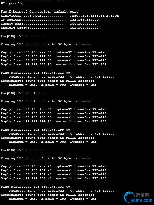

Test 2: from Vlan4 to ping vlan2 vlan3 Vlan4
Go to PC4 make ping.   Result: Pass
