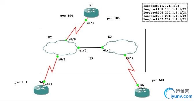

网络拓扑图:
1111
1111
前提条件:Spoke端不能互访
1、手动指neighbor  (HUB端指向Spoke端)
2、手工指定DR (建议指定HUB端为DR、做法调高HUB端的priority.把Spoke端的优先级设置为0、表示不参与DR的选举)
3、手工写MAP
R1:
interface Serial0/0
ip address 145.1.1.1 255.255.255.0
encapsulation frame-relay
ip ospf priority 2               //优先级调高,确保HUB端为DR。
serial restart-delay 0
end
interface Loopback0
ip address 1.1.1.1 255.255.255.0
interface Loopback100
ip address 100.1.1.1 255.255.255.0
interface Loopback200
ip address 200.1.1.1 255.255.255.0
interface Loopback201
ip address 201.1.1.1 255.255.255.0
interface Loopback202
ip address 202.1.1.1 255.255.255.0
路由表:
     1.0.0.0/24 is subnetted, 1 subnets
C       1.1.1.0 is directly connected, Loopback0
     100.0.0.0/24 is subnetted, 1 subnets
C       100.1.1.0 is directly connected, Loopback100
     4.0.0.0/32 is subnetted, 1 subnets
O       4.4.4.4 [110/65] via 145.1.1.4, 00:23:25, Serial0/0
C    201.1.1.0/24 is directly connected, Loopback201
     5.0.0.0/32 is subnetted, 1 subnets
O       5.5.5.5 [110/65] via 145.1.1.5, 00:23:25, Serial0/0
C    200.1.1.0/24 is directly connected, Loopback200
C    202.1.1.0/24 is directly connected, Loopback202
     145.1.0.0/24 is subnetted, 1 subnets
C       145.1.1.0 is directly connected, Serial0/0
R4:
interface Serial0/1
ip address 145.1.1.4 255.255.255.0
ip ospf priority 0                   //优先级设为0,表示不参加DR的选举
frame-relay map ip 145.1.1.5 401 broadcast  //手工指去往R5的MAP
end
路由表:
     1.0.0.0/32 is subnetted, 1 subnets
O       1.1.1.1 [110/65] via 145.1.1.1, 00:22:56, Serial0/1
     100.0.0.0/32 is subnetted, 1 subnets
O       100.1.1.1 [110/65] via 145.1.1.1, 00:22:56, Serial0/1
     4.0.0.0/24 is subnetted, 1 subnets
C       4.4.4.0 is directly connected, Loopback0
     201.1.1.0/32 is subnetted, 1 subnets
O       201.1.1.1 [110/65] via 145.1.1.1, 00:22:56, Serial0/1
O       5.5.5.5 [110/65] via 145.1.1.5, 00:22:56, Serial0/1
     200.1.1.0/32 is subnetted, 1 subnets
O       200.1.1.1 [110/65] via 145.1.1.1, 00:22:56, Serial0/1
     202.1.1.0/32 is subnetted, 1 subnets
O       202.1.1.1 [110/65] via 145.1.1.1, 00:22:57, Serial0/1
C       145.1.1.0 is directly connected, Serial0/1
R5:
interface Serial0/1
ip address 145.1.1.5 255.255.255.0
ip ospf priority 0
frame-relay map ip 145.1.1.5 401 broadcast    //手工指去往R4的MAP
end
