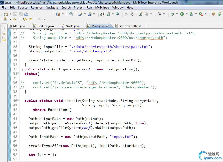

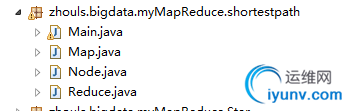

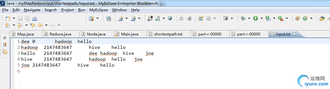

  不多说,直接上代码。

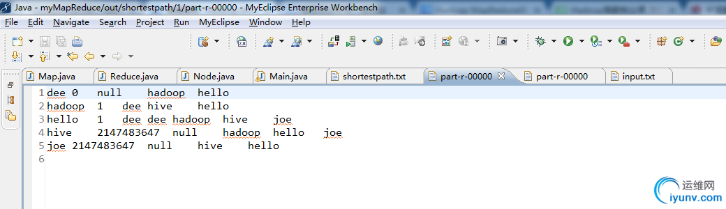

  =  Iteration:    1
  =  Input path:   out/shortestpath/input.txt
  =  Output path:  out/shortestpath/1
  2016-12-12 16:37:05,638 INFO [org.apache.hadoop.metrics.jvm.JvmMetrics] - Initializing JVM Metrics with processName=JobTracker, sessionId=

  output -> K[dee],V[0hadoophello]
  output -> K[hadoop],V[1dee]
  output -> K[hello],V[1dee]
  input -> K[hadoop],V[2147483647nullhivehello]
  output -> K[hadoop],V[2147483647hivehello]
  input -> K[hello],V[2147483647nulldeehadoophivejoe]
  output -> K[hello],V[2147483647deehadoophivejoe]
  input -> K[hive],V[2147483647nullhadoophellojoe]
  output -> K[hive],V[2147483647hadoophellojoe]
  input -> K[joe],V[2147483647nullhivehello]
  output -> K[joe],V[2147483647hivehello]

  input -> K[dee]
  input -> V[0hadoophello]
  output -> K[dee],V[0nullhadoophello]
  input -> K[hadoop]
  input -> V[2147483647hivehello]
  input -> V[1dee]
  output -> K[hadoop],V[1deehivehello]
  input -> K[hello]
  input -> V[2147483647deehadoophivejoe]
  input -> V[1dee]
  output -> K[hello],V[1deedeehadoophivejoe]
  input -> K[hive]
  input -> V[2147483647hadoophellojoe]
  output -> K[hive],V[2147483647nullhadoophellojoe]
  input -> K[joe]
  output -> K[joe],V[2147483647nullhivehello]

  input -> K[dee]
  input -> V[2dee:hello]
  input -> V[0nullhadoophello]
  input -> K[hadoop]
  input -> V[1null:dee]
  input -> V[1deehivehello]
  output -> K[hadoop],V[1null:deehivehello]
  input -> K[hello]
  input -> V[1deedeehadoophivejoe]
  input -> V[2dee:hadoop]
  input -> K[hive]
  input -> V[2147483647nullhadoophellojoe]
  output -> K[hive],V[2dee:hadoophadoophellojoe]
  input -> K[joe]
  input -> V[2147483647nullhivehello]
  output -> K[joe],V[2dee:hellohivehello]

  package zhouls.bigdata.myMapReduce.shortestpath;
  import org.apache.hadoop.io.Text;
  import org.apache.hadoop.mapreduce.Mapper;
  import java.io.IOException;
  public>  extends Mapper<Text, Text, Text, Text> {

  public final>  public static final String TARGET_NODE = "shortestpath.targetnode";
  public static void main(String... args) throws Exception {
  String startNode = "dee";
  String targetNode = "joe";
  //    String inputFile = "hdfs://HadoopMaster:9000/shortestpath/shortestpath.txt";
  //    String outputDir = "hdfs://HadoopMaster:9000/out/shortestpath";
  String inputFile = "./data/shortestpath/shortestpath.txt";
  String outputDir = "./out/shortestpath";
  iterate(startNode, targetNode, inputFile, outputDir);
  public static Configuration conf = new Configuration();
  static{
  //  conf.set("fs.defaultFS", "hdfs://HadoopMaster:9000");
  //  conf.set("yarn.resourcemanager.hostname", "HadoopMaster");
  public static void iterate(String startNode, String targetNode,
  String input, String output)
  throws Exception {
  Path outputPath = new Path(output);
  outputPath.getFileSystem(conf).delete(outputPath, true);
  outputPath.getFileSystem(conf).mkdirs(outputPath);
  Path inputPath = new Path(outputPath, "input.txt");
  createInputFile(new Path(input), inputPath, startNode);
  int iter = 1;
  while (true) {
  Path jobOutputPath =
  new Path(outputPath, String.valueOf(iter));
  System.out.println("======================================");
  System.out.println("=  Iteration:    " + iter);
  System.out.println("=  Input path:   " + inputPath);
  System.out.println("=  Output path:  " + jobOutputPath);
  if(findShortestPath(inputPath, jobOutputPath, startNode, targetNode)) {
  break;
  inputPath = jobOutputPath;
  iter++;
  public static void createInputFile(Path file, Path targetFile,
  String startNode)
  throws IOException {
  FileSystem fs = file.getFileSystem(conf);
  OutputStream os = fs.create(targetFile);
  LineIterator iter = org.apache.commons.io.IOUtils
  .lineIterator(fs.open(file), "UTF8");
  while (iter.hasNext()) {
  String line = iter.nextLine();
  String[] parts = StringUtils.split(line);
  int distance = Node.INFINITE;
  if (startNode.equals(parts[0])) {
  distance = 0;
  IOUtils.write(parts[0] + '\t' + String.valueOf(distance) + "\t\t",

  public static boolean findShortestPath(Path inputPath,
  Path outputPath, String startNode,
  String targetNode)
  throws Exception {
  conf.set(TARGET_NODE, targetNode);
  Job job = new Job(conf);
  job.setJarByClass(Main.class);
  job.setMapperClass(Map.class);
  job.setReducerClass(Reduce.class);
  job.setInputFormatClass(KeyValueTextInputFormat.class);
  job.setMapOutputKeyClass(Text.class);
  job.setMapOutputValueClass(Text.class);
  FileInputFormat.setInputPaths(job, inputPath);
  FileOutputFormat.setOutputPath(job, outputPath);
  if (!job.waitForCompletion(true)) {
  throw new Exception("Job failed");
  Counter counter = job.getCounters()
  .findCounter(Reduce.PathCounter.TARGET_NODE_DISTANCE_COMPUTED);
  if(counter != null && counter.getValue() > 0) {
  CounterGroup group = job.getCounters().getGroup(Reduce.PathCounter.PATH.toString());
  Iterator<Counter> iter = group.iterator();
  iter.hasNext();
  String path = iter.next().getName();
  System.out.println("==========================================");
  System.out.println("= Shortest path found, details as follows.");
  System.out.println("= ");
  System.out.println("= Start node:  " + startNode);
  System.out.println("= End node:    " + targetNode);
  System.out.println("= Hops:        "  + counter.getValue());
  System.out.println("= Path:        "  + path);
  return true;
  return false;
