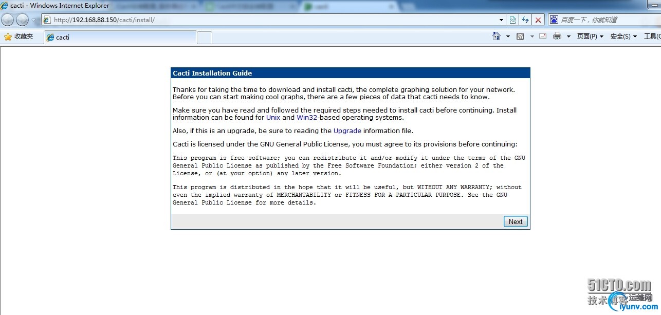

13.访问web
http://192.168.88.150/cacti/
安装完成,默认用户名和密码是admin,第一次登录会要求更改密码

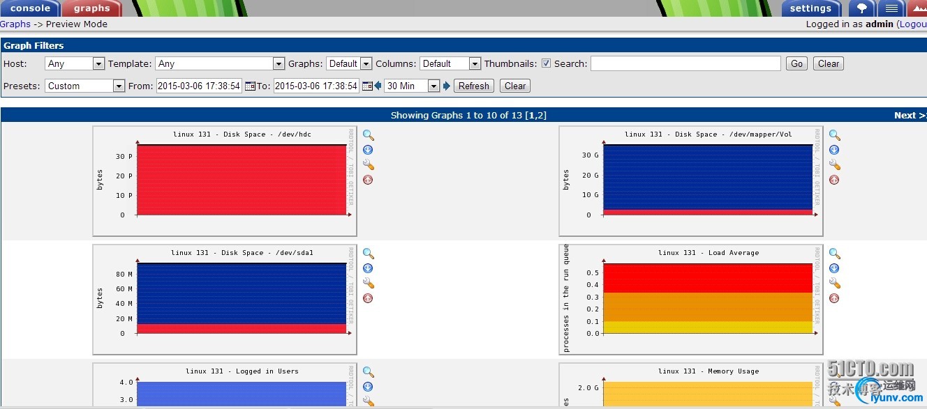

14.出图要等一会的
查看如果有图,没有曲线,重启apache,/usr/bin/php /var/www/html/cacti/poller.php
tail -f /var/log/messages

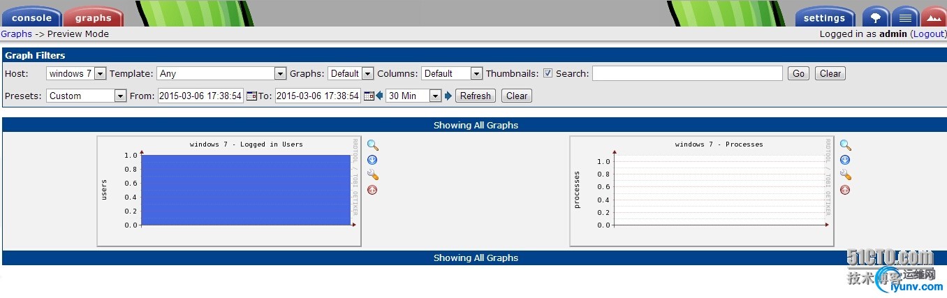

三、配置被监控Linux主机
1.在被监控主机上
[iyunv@localhost ~]#egrep -v "^$|#" /etc/snmp/snmpd.conf
com2sec notConfigUser default public
group notConfigGroup v1 notConfigUser
group notConfigGroup v2c notConfigUser
view systemview included .1.3.6.1.2.1.1
view systemview included .1.3.6.1.2.1.25.1.1
access notConfigGroup "" any noauth exact all none none
view all included .1 80
syslocation Unknown (edit /etc/snmp/snmpd.conf)
syscontact Root  (configure /etc/snmp/snmp.local.conf)
dontLogTCPWrappersConnects yes
2.重启snmpd服务
[iyunv@localhost ~]#service snmpd restart
