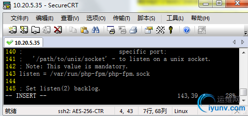

#配置php-fpm,编辑php-fpm.conf,找到listen那一行,修改成如下内容:
[root@shuiyong php-5.4.0]# vim /usr/local/php/etc/php-fpm.conf
143 listen = /var/run/php-fpm/php-fpm.sock
#创建php-fpm目录,启动php-fpm
[root@shuiyong php-5.4.0]# mkdir /var/run/php-fpm

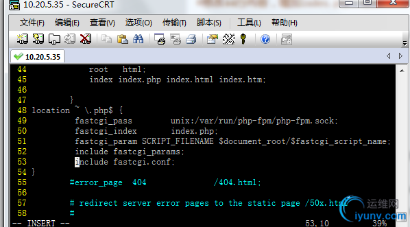

#然后配置nginx,编辑nginx配置文件
[root@shuiyong sbin]# cd /usr/src/php-5.4.0/
[root@shuiyong php-5.4.0]# vim /etc/nginx/nginx.conf
#修改45行内容,增加index.php,添加index.php的首页文件选项
45 index index.php index.html index.htm;
#添加48—54
48 location ~ \.php$ {
49 fastcgi_pass unix:/var/run/php-fpm/php-fpm.sock;
50 fastcgi_index index.php;
51 fastcgi_param SCRIPT_FILENAME $document_root/$fastcgi_script_name;
52 include fastcgi_params;
53 include fastcgi.conf;
54 }
#修改完毕后保存退出重启nginx:
[root@shuiyong php-5.4.0]# service nginx restart
nginx: the configuration file /etc/nginx/nginx.conf syntax is ok
nginx: configuration file /etc/nginx/nginx.conf test is successful
Stopping nginx: [ OK ]
Starting nginx: [ OK ]

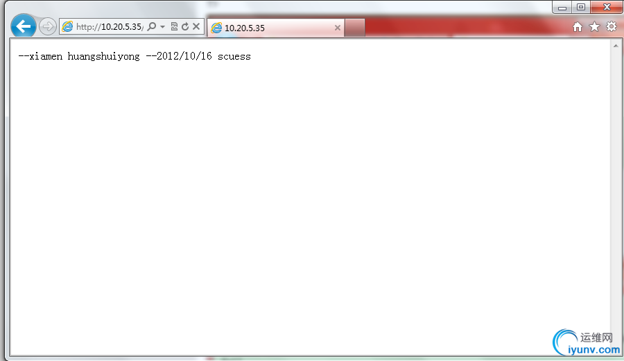

2.2.2      测试nginxmysql的连接
#测试成功
[root@shuiyong html]# vim /usr/html/index.php
<?php
phpinfo();
--xiamen huangshuiyong
--2012/10/16
<?php
$link=mysql_connect('127.0.0.1','root','');
if($link)
echo &quot;scuess&quot;;
else
echo &quot;fail&quot;;
