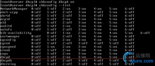

[root@server ~]# chkconfig dhcpd on           设为开机启动
[root@server ~]# chkconfig --list
