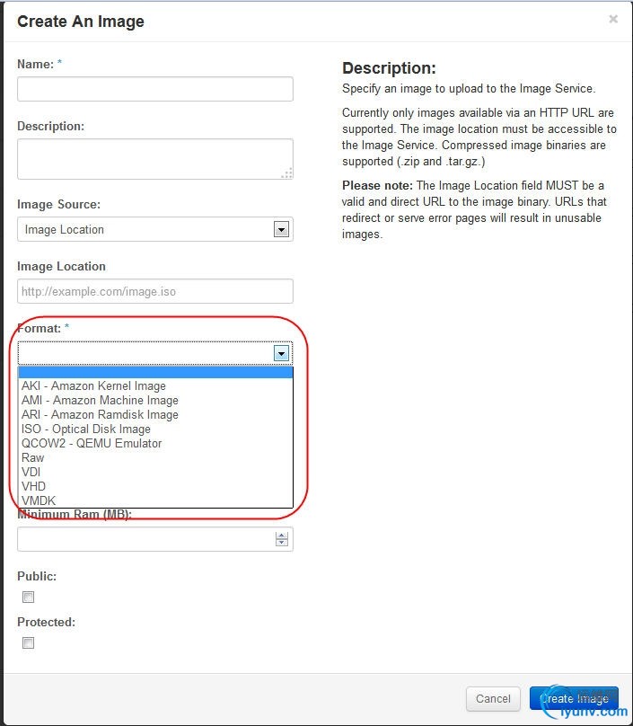

  1. you can use vmware workstation to build images, then upload to glance using dashboard

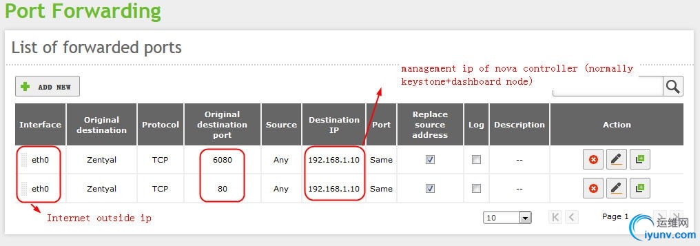

  Access novnc console from Internetmethod2
  1. you can publish dashboard web site to Internet (normally keystone+dashboard node)
  2. on computer node, vi /etc/nova/nova.conf
novncproxy_base_url=http://public_ip_address_of_firewall:6080/vnc_auto.html
service openstack-nova-compute restart
  3. nova get-vnc-console CirrOS novnc
  http://public_ip_address_of_firewall:6080/vnc_auto.html?token=4f9c1f7e-4288-4fda-80ad-c1154a954673
