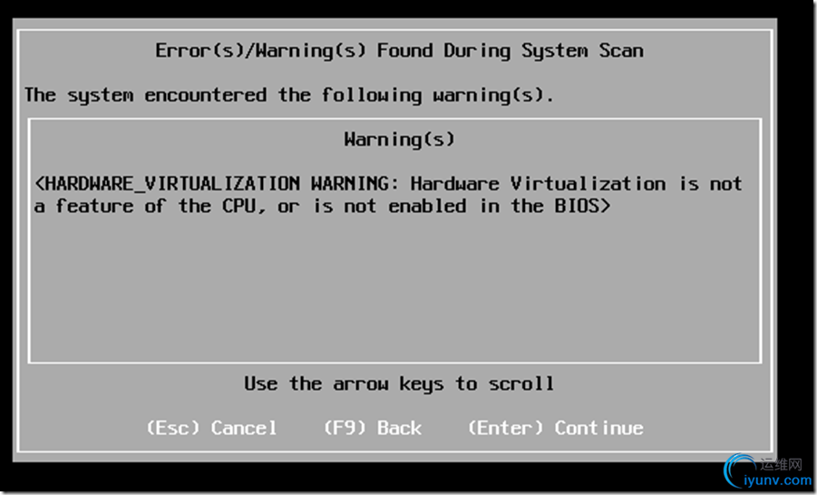

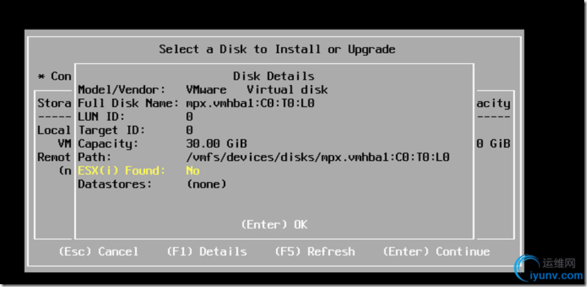

  Open the VM in console and power it up. You should see it trying to boot from the network. Click the CD ROM picture with the wrench on it and attach the VM to either a stored .iso or a local .iso or a local CD ROM that has the ESXi hypervisor installation. Restart the VM by sending ctrl-alt-del to the VM.
  If everything is working correctly you should not get the dreaded “”
  If you do get that message when installing ESXi then check back over the previous steps. I think the 3 Key ingredients to this working (making sure the CPU has VT-x and EPT of course) are as follows:
  • You must add the vhv.allow = “TRUE” to the config file on the Physical Host.
  • You must have the OS of the virtual guest you are installing ESXi on selected as VMware ESXi 5.x
  • You must select that last option for CPU/MMU Virtualization

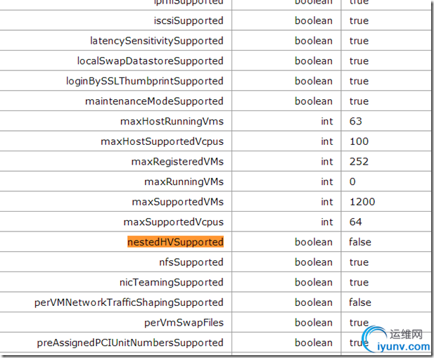

  可以查看esxi的如下web地址
  https://[your-esxi-host-ip-address]/mob/?moid=ha-host&doPath=capability
  的"nestedHVSupported"项目来确认是否支持VHV

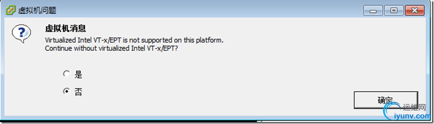

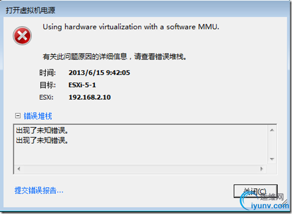

  报错:
  因为R300不支持VHV,所以弹出:
