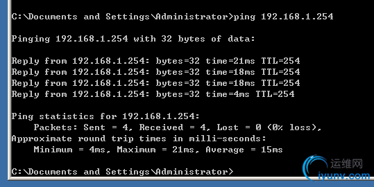

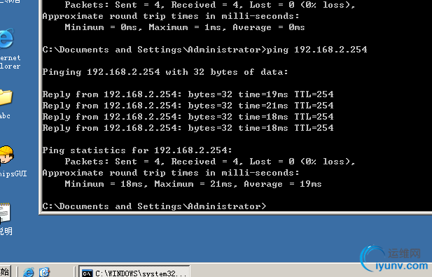

  本地虚拟机测试:

  [r2]ping 192.168.2.254
  PING 192.168.2.254: 56  data bytes, press CTRL_C to break
  Reply from 192.168.2.254: bytes=56 Sequence=0 ttl=255 time = 25 ms
  Reply from 192.168.2.254: bytes=56 Sequence=1 ttl=255 time = 25 ms
  Reply from 192.168.2.254: bytes=56 Sequence=2 ttl=255 time = 25 ms
  Reply from 192.168.2.254: bytes=56 Sequence=3 ttl=255 time = 25 ms
  Reply from 192.168.2.254: bytes=56 Sequence=4 ttl=255 time = 25 ms
  --- 192.168.2.254 ping statistics ---
  5 packets transmitted
  5 packets received
  0.00% packet loss
  round-trip min/avg/max = 25/25/25 ms
  [r2]ping 192.168.1.254
  PING 192.168.1.254: 56  data bytes, press CTRL_C to break
  Reply from 192.168.1.254: bytes=56 Sequence=0 ttl=255 time = 25 ms
  Reply from 192.168.1.254: bytes=56 Sequence=1 ttl=255 time = 25 ms
  Reply from 192.168.1.254: bytes=56 Sequence=2 ttl=255 time = 25 ms
  Reply from 192.168.1.254: bytes=56 Sequence=3 ttl=255 time = 25 ms
  Reply from 192.168.1.254: bytes=56 Sequence=4 ttl=255 time = 25 ms
  --- 192.168.1.254 ping statistics ---
  5 packets received
  0.00% packet loss
