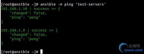

  Check the connectivity of ‘test-servers’ or ansible nodes using ping
  使用ping检查ansible节点和测试服务器的连通性
[root@ansible ~]# ansible -m ping 'test-servers'

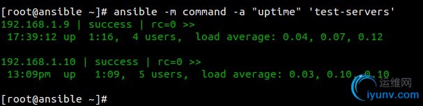

  Example :1 Check the uptime of Ansible nodes
  检查Ansible节点的运行时间
[root@ansible ~]# ansible -m command -a "uptime" 'test-servers'
