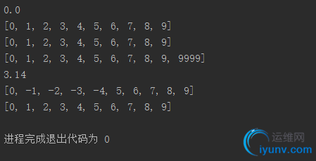

  Value,Array
#!/usr/local/python27/bin/python2.7
# coding=utf8
# noinspection PyUnresolvedReferences
# 通过Value Array 实现进程间的内存共享
from multiprocessing import Value,Array,Process
def f(n,a,raw):
    n.value = 3.14
    for i in range(5):
        a = -a
    raw.append(9999)
    print(raw)
if __name__ == '__main__':
    num = Value('d',0.0)
    arr = Array('i',range(10))
    raw_list = range(10)
    print(num.value)
    print(arr[:])
    print(raw_list)
#调用子进程之后,重新打印array和value,值将会发生改变。 而raw_list 普通列表在外层打印则没有发生改变。
    p = Process(target=f,args=(num,arr,raw_list))
    p.start()
    p.join()
    print(num.value)
    print(arr[:])
    print(raw_list)
  执行结果:

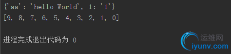

  Manager
# coding=utf8
from multiprocessing import Process,Manager
def f(d,l):
    d[1] = '1'
    d['aa'] = 'hello World'
    l.reverse()
    manager = Manager()
    d = manager.dict()
    l = manager.list(range(10))
    p = Process(target=f,args=(d,l))
    p.start()
    p.join()
    print(d)
    print(l)
  执行结果:
