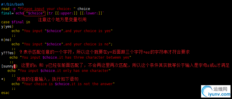

  3 条件判断:case语句
  语法如下
case 变量引用($var,注意有$符号引用)  in
PAT1)
分支1
PAT2)
分支2
默认分支
esac
  这里的分支x可以是命令的组合,不是单纯的一条命令
  case支持glob风格的通配符:
  *: 任意长度任意字符
  ?: 任意单个字符
  []:指定范围内的任意单个字符
  a|b: a或b,当匹配到不同的字符,但是要执行相同的分支命令是,可以用这个命令简化判断
  例子
#!/bin/bash
read -p "Please input your choice: " choice
final=`echo "$choice" |tr [[:upper:]] [[:lower:]]`
case $final in
y|yes)
echo "You input "$choice",and your choice is yes"
n|no)
echo "You input "$choice",and your choice is no";
y???es)
echo "You input $choice,it has three character between yes"
[sunny])
echo "You input $choice,it only has one character"
echo "Your choice is $choice,it is not the answer"
esac
  截图如下
