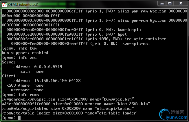

Getting Information about the Guest System
  To get information about the guest system, use the info option command. If used without any option, the list of possible options is printed. Options determine which part of the system will be analyzed:
info version  Shows the version of QEMU

  info kvmShows the KVM information

  info vncShows the VNC server status

  info romsShows the ROMs

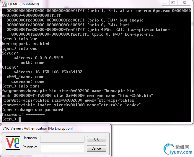

Changing VNC Password
  To change the VNC password, use the change vnc password command and enter the new password:
(qemu) change vnc password
Password: ********
(qemu)
