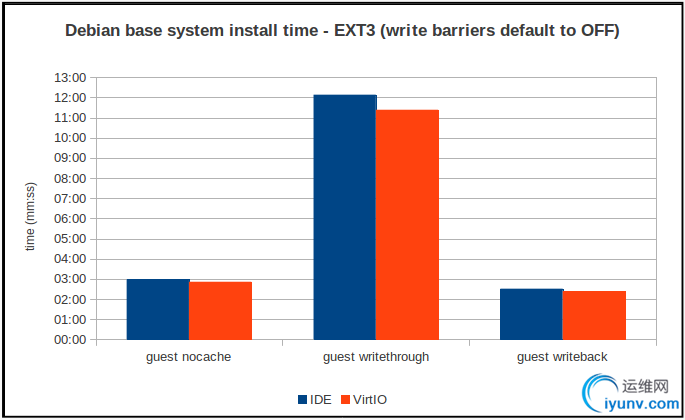

Debian base system installation time – EXT3 and no guest-side write barriers
  Now we can see how the various caching policies affect a Debian base system installation time. Will a real-world scenario redeem the historically safer write-through mode?
  In the case of a guest operating system with default-configured EXT3, it seems no: the writethrough policy remains way slower than the others. While the nocache mode shows remarkably good result, the write-back one is marginally faster thank to its use of not only guest-side, but also host-side pagecaches.
  This is a perfect example of the safety vs speed trade-off described above: the guest OS does not use write barriers and so the writeback mode is significantly prone to data loss (because the synchronized guest-side writes are cached in the host-side pagecache before to be flushed to permanent storage) , while the writethrough mode, while slower, is even safer than this guest OS configuration running on the real hardware.
  In this case, a good compromise between safety and performance is the nocache mode: it provide a safety level comparable to that achieved by this guest OS instance running on real hardware, as synchronized guest-side writes are cached in disk's internal cache only.

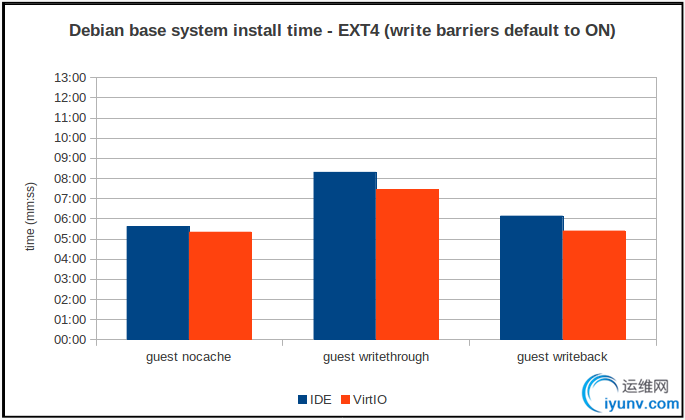

Debian base system installation time – EXT4 and guest-side write barriers enabled
  While the previous test show remarkably well the situation when using relatively old guest filesystems, what happens when we use a modern, barrier-optimized filesystems as EXT4 inside our guest?
  Things become definitely more interesting: while slower, the writethrough setting regain competitiveness. However with guest-side write barriers turned on it isn't any more secure than the other caching methods.
  Speaking between the nocache and write-back settings, we can see that the former has a slight edge in IDE mode: this is probably due to the “I-am-trying-to-use-host-cache-but-I-can't-really-use-it” situation in which the writeback mode find itself in this test (a .deb package installation is a mix of uncompressing and synchronized write to disk).
  However, the two modes are more-or-less on par. This means that, when using a write-barriers aware guest filesystem, you can use one of these two settings, without boring with the slower write-through one. Conclusions
