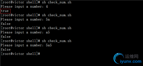

  实例演示:
  #!/bin/bash
  read -t 10 -p "Please input a number: " NUM
  STRING=`echo ${NUM} |sed 'sS^[0-9].*$SS' `
  [[ -z ${STRING} ]] && echo true || echo false
  执行如下:

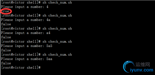

  实例演示:
  #!/bin/bash
  [[ ${NUM} =~ ^[0-9]+$ ]] && echo true || echo false
  执行结果:
