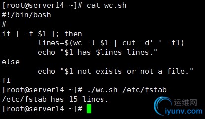

  (1)ls `which cat`
  (2) lines=$(wc -l /etc/fstab | cut -d'' -f1)
