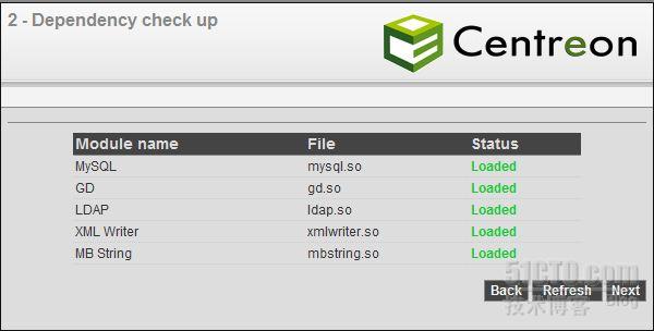

(2)检查依赖关系

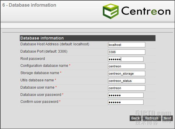

(6)配置数据库信息

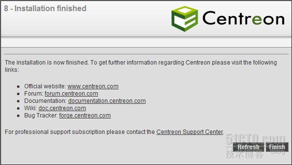

(7)安装
(8)安装完成

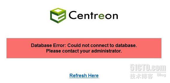

三.后续登录错误
1.错误信息
2.日志信息
25/4/2013 18:36:01 - 25/4/2013 18:36:1 - DBI connect('database=centreon_storage;host=localhost:3306','centreon',...) failed: Access denied for user 'centreon'@'localhost' to database 'centreon_storage' at /usr/local/centreon/bin/logAnalyser line 596
3.解决方法
mysql> grant all on centreon.* to centreon@localhost identified by '123456';
Query OK, 0 rows affected (0.07 sec)mysql> grant all on centreon_status.* to centreon@localhost identified by '123456';
mysql> grant all on centreon_storage.* to centreon@localhost identified by '123456';
mysql> flush privileges;
Query OK, 0 rows affected (0.06 sec)

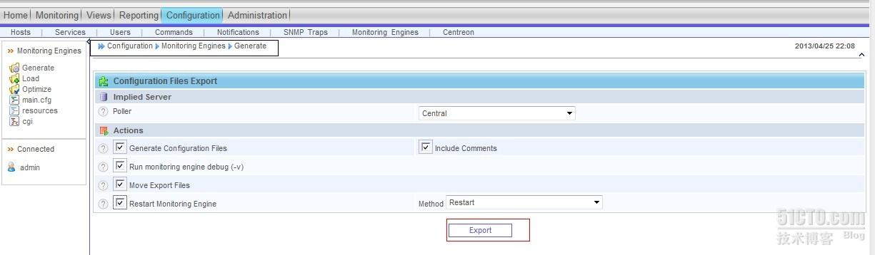

四.检查重新生成配置文件
(1)检查main.cfg的配置
(2)检查ndo2db.cfg的配置
(3)检查ndomod.cfg的配置
(4)生成nagios配置文件
web页面重启完成后,查看nagios相关日志
