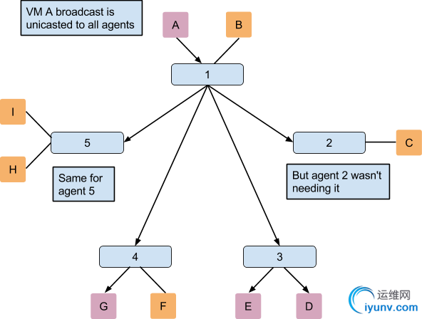

  • More about broadcasts: What if a node isn’t hosting any ports in a specific network? Should this node receive broadcast traffic designated to that network?
  A great visual explanation for the third point, stolen shamelessly from the official OpenStack documentation:
  Overview
  When using the ML2 plugin with tunnels and a new port goes up, ML2 sends a update_port_postcommit notification which is picked up and processed by the l2pop mechanism driver. l2 pop then gathers the IP and MAC of the port, as well as the host that the port was scheduled on; It then sends an RPC notification to all layer 2 agents. The agents uses the notification to solve the three issues detailed above.
