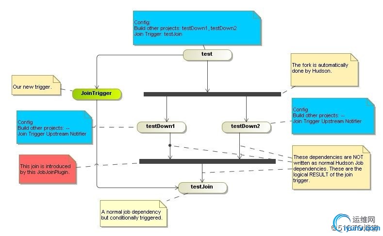

  This plugin allows a job to be run after all the immediate downstream jobs have completed.   In this way,  the execution can branch out and perform many steps in parallel, and then run a final aggregation step just once after all the parallel work is finished.
  The plugin is useful for creating a 'diamond' shape project dependency.   This means there is a single parent job that starts several downstream jobs.   Once those jobs are finished, a single aggregation job runs.   More complex interactions are not possible with this plugin.
  The downstream projects are specified using Hudson's normal project>  此插件允许在所有直接下游作业完成后运行一个作业。通过这种方式,执行可以并行地分支并执行许多步骤,然后在所有并行工作完成后,最后运行一次聚合步骤。
  这个插件对于创建一个“菱形”依赖项非常有用。这意味着有一个单亲作业启动几个下游作业。一旦这些工作完成,一个聚合作业就会运行。此插件不可能实现更复杂的交互。
  下游项目是使用jenkins的正常项目关系机制来指定的。

  Thisplugin allows a job to be run after all the immediate downstream jobs havecompleted.   In this way,  the execution can branch out andperform many steps in parallel, and then run a final aggregation step just onceafter all the parallel work is finished. (Jobs 按照既定的顺序执行)
执行顺序
  Test 执行
  Test执行完毕
  testDown 与testDown2并行执行
  testDown执行完毕
  testDown2执行完毕
  testJoin开始执行
  testJoin执行完毕

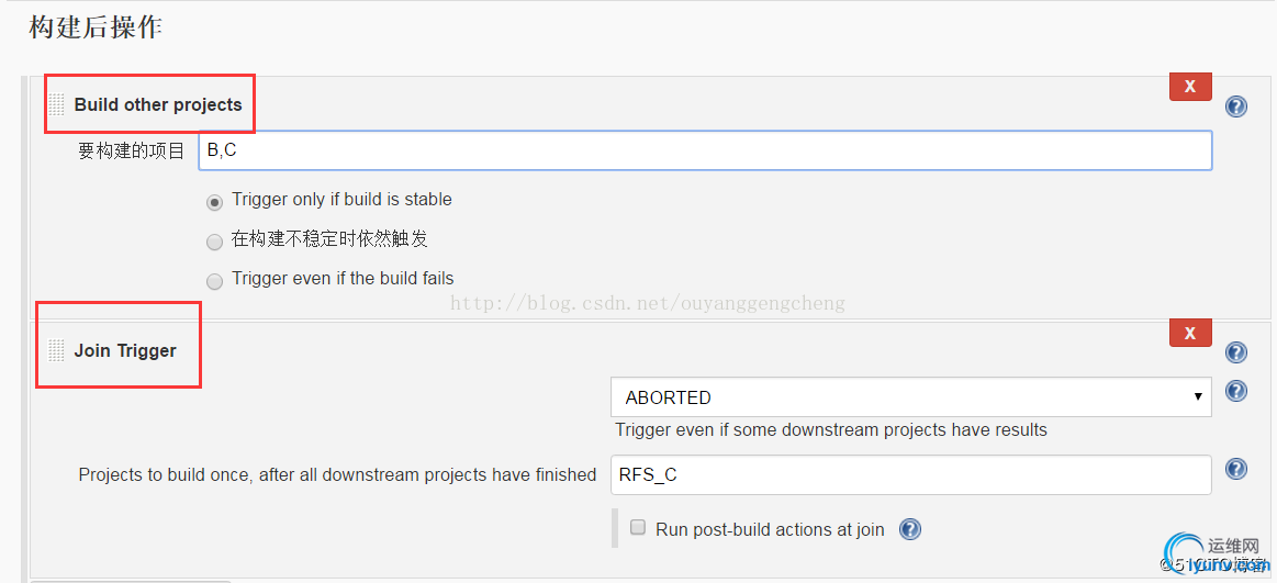

2.JOIN Plugin
  这个插件作用主要是会让整个job的下游job全部完成后再执行。所以场景为A、B、C、D四个job,A的下游为B、C,然后A设置的join trigger为D,这样D会等B、C两个job完成再运行D而达到效果。
  A:设置两个下游B、C,设置join trigger为D
  B:运行部分用例,设置Archive the artifacts把结果文件传递
  C:运行部分用例,设置Archive the artifacts把结果文件传递
  D:把B、C的结果文件放在workspace中,合并结果集
