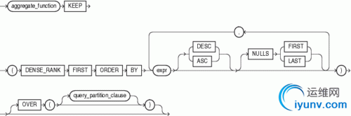

1.   Syntax
  Purpose
  FIRST and LAST are very similar functions.Both are aggregate and analytic functions that operate on a set of values froma set of rows that rank as the FIRST or LAST withrespect to a given sorting specification. If only one row ranks as FIRSTor LAST, then the aggregate operates on the set with only one element.
  If you omit the OVERclause, then the FIRST and LAST functions are treated as aggregate functions. You can use thesefunctions as analytic functions by specifying the OVER clause. Thequery_partition_clause is the only part of the OVER clause valid with thesefunctions. If you include the OVER clause but omit thequery_partition_clause, then the function is treated as an analytic function, but the window defined for analysis is theentire table.
  中文说明:省略over子句,Fisrt/Last被当做聚合函数使用,见示例1;含over关键字但没query_partition_clause,Fisrt/Last被当做分析函数使用,分析的窗口是整个表,见示例2。
  These functions take as an argument anynumeric data type or any nonnumeric data type that can be implicitly convertedto a numeric data type. The function returns the same data type as the numericdata type of the argument.
  When you need a value from the first orlast row of a sorted group, but the needed value is not the sort key, the FIRSTand LAST functions eliminate the need for self-joins or views and enable betterperformance.
  The aggregate_functionargument is any one of the MIN, MAX, SUM, AVG, COUNT, VARIANCE, or STDDEVfunctions. It operates on values from the rows thatrank either FIRST or LAST. If only one row ranks as FIRST or LAST, then theaggregate operates on a singleton (nonaggregate) set.
  The KEEP keyword is for semantic clarity.It qualifies aggregate_function, indicating that only the FIRST or LAST valuesof aggregate_function will be returned.
  DENSE_RANK FIRST or DENSE_RANK LASTindicates that Oracle Database will aggregate over only those rows with theminimum (FIRST) or the maximum (LAST) dense rank (also called olympic rank).
